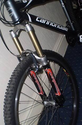

So I've just sourced a set of Marzocchi Z1 drop off freeride with a massive 5" of travel (5" is massive but I'm talking forks here :wink: ). Black with red decals so will look OK. Here's a pic from the Seller

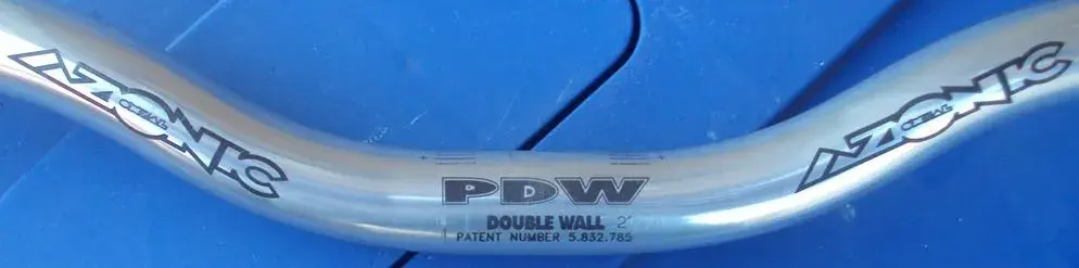

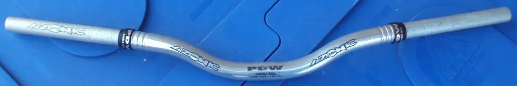

As for risers on it, I've an Azonic PDW 2" rise riser in silver.

Xizang what's the width on those Azonic bars and are they in good nick?
685mm possibly 700mm (I'll need to re-measure if needed).
