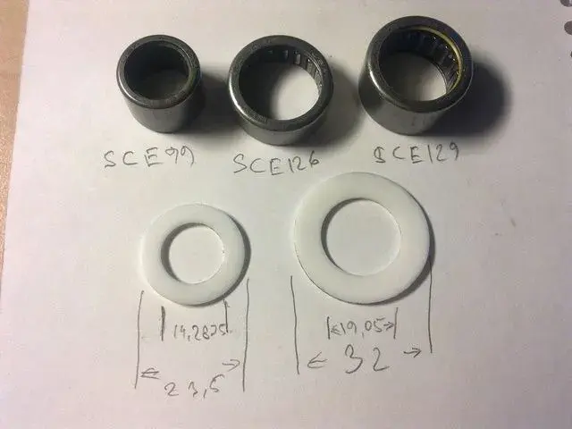

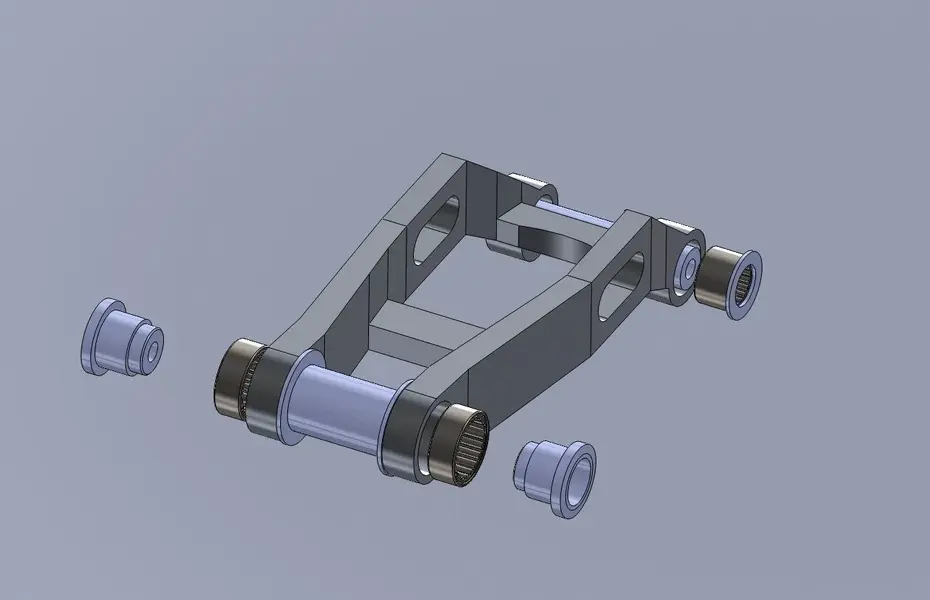

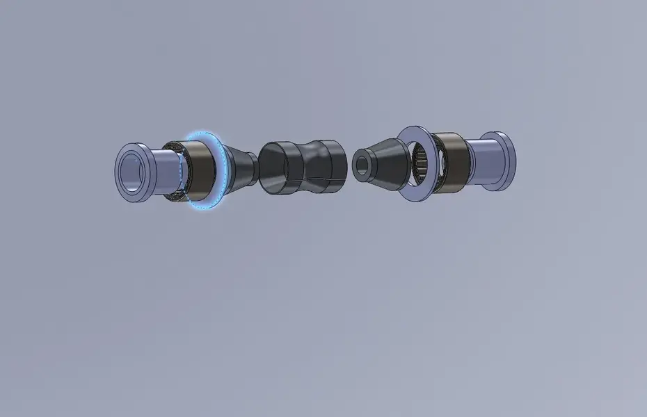

Thanks everybody for information. My problem was that BETD set is based on ball bearings and I recieved a set of GT original replacement parts. And they use needle bearings everywhere except for horst link.
I'll have to machine an upper link a little bit because upper rear axle holes were 18mm in diameter but roller bearings from GT for this joint are
SCE99:
- 19,05mm (3/4") outer diameter
- 14.2875mm (9/16") inner diameter
- 14.2875mm (9/16") width
this bearing has one sided sealing
Same for upper frame link. Hole for bearing is 25mm but roller bearings are SCE126
- 25.4mm (1") outer diameter
- 19,05mm (3/4") inner diameter
- 9,525mm (3/8") width
This bearing has no seals
Lower frame link was perfect with 25.4mm hole it fits the supplied bearing perfectly.
Bearing is SCE129:
this bearing has one sided sealing as well.
Kit came with 4 big PTFE washers and 2 small PTFE washers:
Big washer:
- 32mm outer diameter
- 1.6mm thickness
Small washer:
- 23.5mm outer diameter
- 1.1mm thickness
I'll have to verify all the measurements and finalise the drawings.
Then I hope I'll be able to make them.

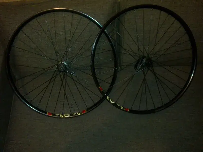

Spoke pattern is classic 36 spokes with 3x cross pattern.
32 spokes give you a straight cross where circle is devided in equal 4 parts with parallel-going spokes. If you do 36 holes - it will have this additional cross section made by additional 4 spokes.
