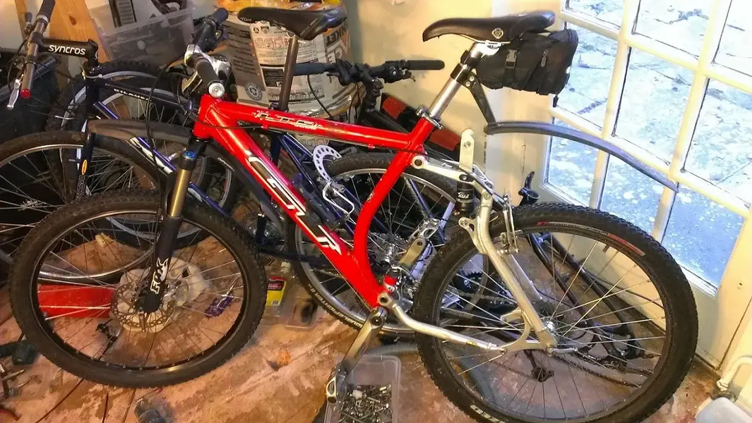

So I picked up a good condition lts a few month back and decided to give it an overhaul.
Made up a bracket to mount a Fox on the back and rebuilt some knackered Fox Talas for the front(which was hard work doing the bushes).
Scavenged a hope mini for the front and 9x3 speed gearing for now.
Rides nice...no pedal bob, climbs well and wafts over the bumpy bits.
Was wonder if anyone else had tried modding/updating an old susser?
