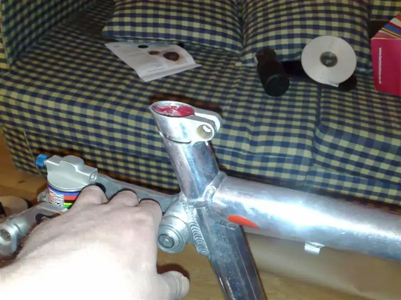

just a wee update to show yous what i have been doing to my Gt Lts 1000-xc
got a few problems though if any of yous can help
rear Derailleur hits the spokes and only can get it to work with 6 of the 7 gears
and
front disc pads are rubbing discs
any help would be great

adjusting the little screws at the back of the mech will allow you to alter the travel of the mech.
L..... low gear (the big one)
H......high gear (the small one)
ie if you screw the L screw clock wise it will begin to miss your spoke and screw to H one anti -clock-wise it will drop further down

Agree, sounds like the stop screws in the rear mech needing adjusted.
When you say the pads are rubbing the disc are they stopping the wheel from turning ?, i've found with most discs the pads will rub the discs and the wheel wont spin totaly free and silent like with properly set up rim brake so a little rubbing noise from the disc pads may be normal, at the same time the wheel shouldn't be stiff or binding.
