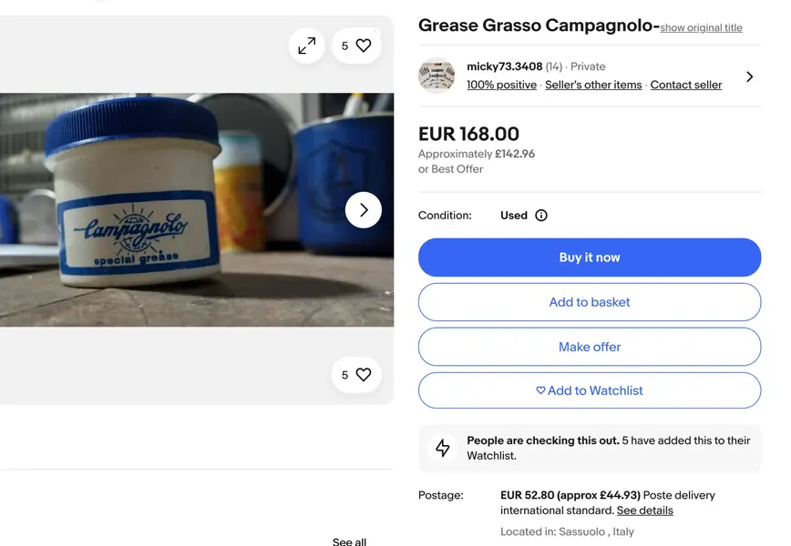

Hang on, so are we saying you don't have to use vintage Campagnolo grease that costs a mere £142 direct from Italy (plus £44 postage for some reason)??? :LOL:
