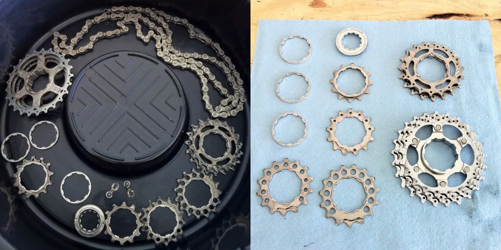

Any tips other than above for really greasy/filthy parts? Got a drivetrain so covered I want to just put it soaking in a bucket in the morning and come back after work. Diesel ok? Need something that wont damage it after a 9 hour soaking.
In a shallow bath of white spirit, 10 minutes scrubbing will do more than 9 hours soaking.
I used to commute 20 miles a day through London on my Cannondale and the drivetrain received a full monthly stripdown, de-grease and re-grease.
Now my road bike gets the same treatment every 3 months or so.
Always found it best to do the cassette and chain off the bike, so KMC/SRAM Powerlinks are useful, as is a chain whip & cassette remover.
Don't forget to include the jockey wheels in the bath, and give the chainrings a thorough wipe down with a spirited rag.
After drying, I re-grease my chain with Finish Line Krytech Wax Lubricant, and pack the jockey wheel bearings with Finish Line Teflon Grease (also used as an assembly lubricant on most other parts of the bike except the BB).
