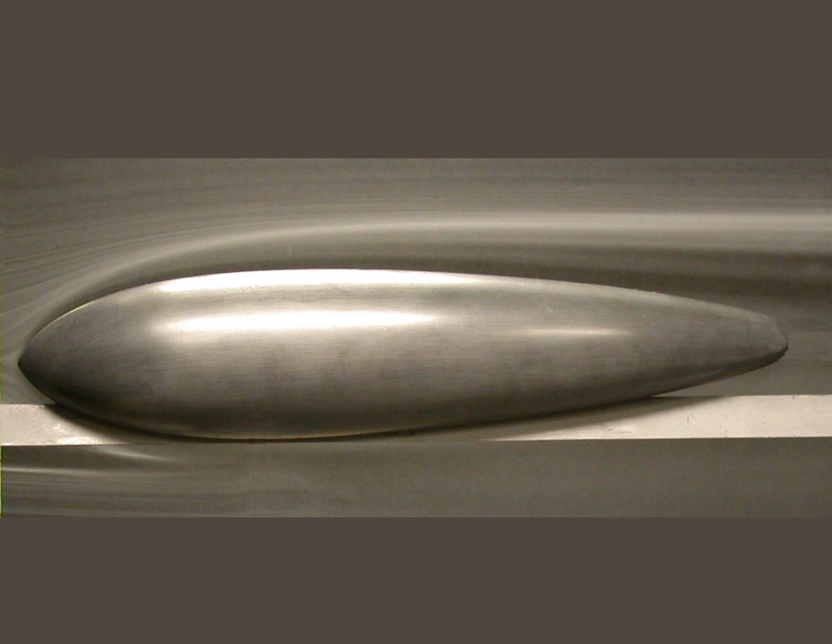

"It will not be the same horizontally when the length will have to be 8ft+ then balanced over the 2 wheels then removing the drag from the wheels and gaps around the wheels. The tear drop shape will have to balance the drag difference top and bottom. "
Completely agree, I think the finished shape would need to be more of a tapered Cigar than a teardrop something along the lines of below but with only smallest portion of the wheels protruding.
