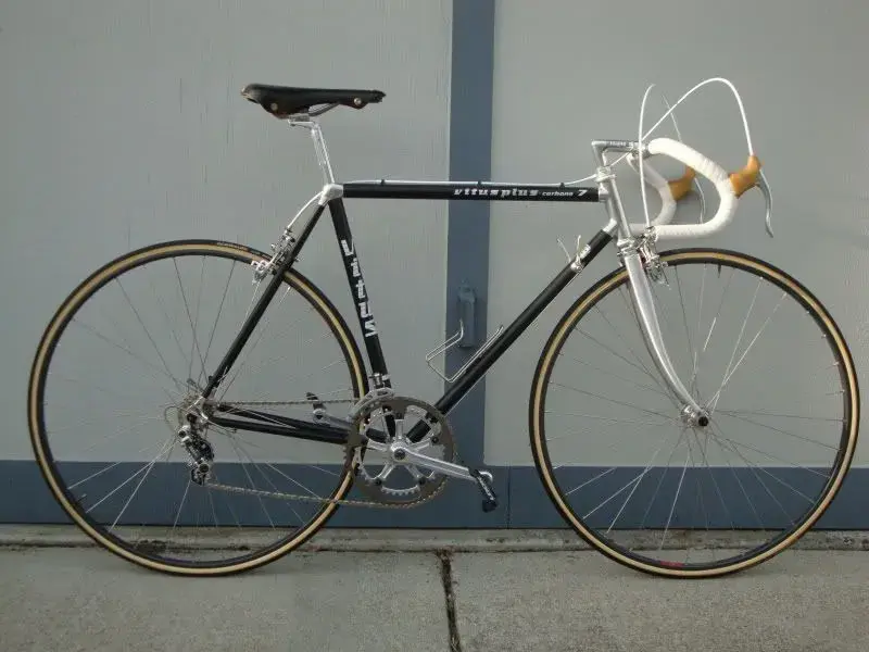

ps I have attached some vitus carbon pics you will like too

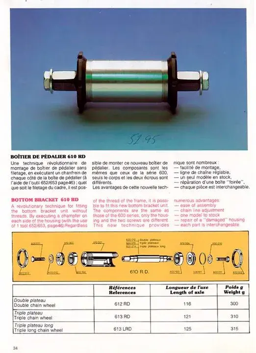

I am building up a 979 with early mavic myself at the moment , fluted cranks and mecano mech etc , the BB shell is fluted but I am going to run with a NOS 111mm centaur cartridge BB instead , It looks like I may have to fit a Modolo speedy brakeset as I cannot get any old mavics
Latman i may have some spare Mavic parts in a few days as I've had quite a lot of response from the wanted ad & I bought a headset off ebay & the guy has just e-maild me with a list of other Mavic bits he has.
I thought the Mavic BB was 116mm
Re: GORILLAS ONLY!!! TVT Low Pro
stringfellow1946":2wg6ej41 said:
the BB for double came in 114 and 116 I think
