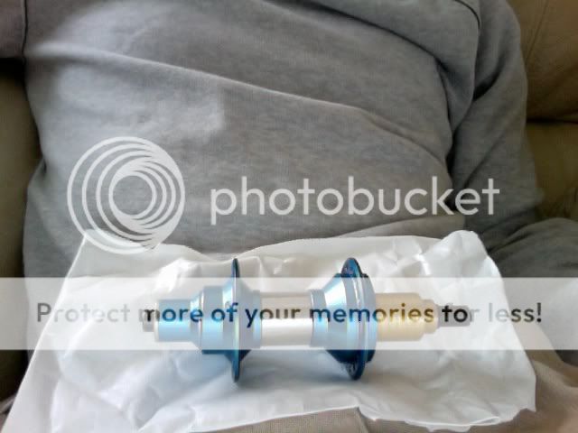

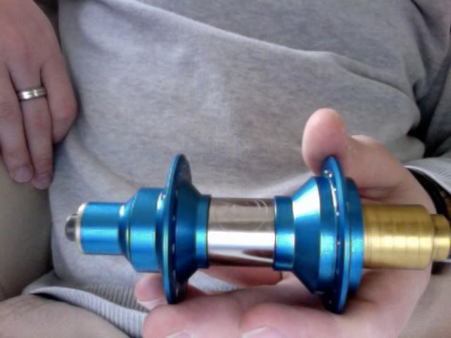

the black and gold one is my nos one and is the same as the one in the brochure, this type has a steel axle with sealed bearing on the none drive side, and a needle bearing that the axle runs directly onto at the drive side. The freehub body sits on a ti nitrate coated body, and runs directly onto that with the oil pictured as lube. The body just pushes on like a hope one.
the red hub in the other pics is a salesman sample, which is an example of the later version, where you can see the ti nitrate body screws in and also holds the freehub body in place as you can see
The black and gold ones are from around 1995
let me know if you have any more questions
