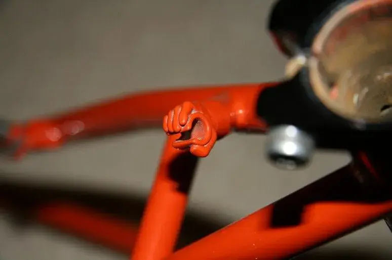

Can anyone, help me in answering what length of bottom bracket spindle I will need to run on my IBIS Steel Handjob, with a set of Cooks RSR Cranks ? Square taper... 110 pcd.. :roll: :roll:

I think you need
Hey Si, think you are going to need a 122.5 mm length bottom bracket for your RSR crank..I got away with a 120mm on my last build though :wink:
I think I have a 122.5 kicking around Si, pop over and try it out before you buy one.
Si
Cool Mate, might even have one myself ! but it wont be Ti so it will have to replaced at some time, but need to make sure of the size, before I buy a Ti one... :wink: :wink:
