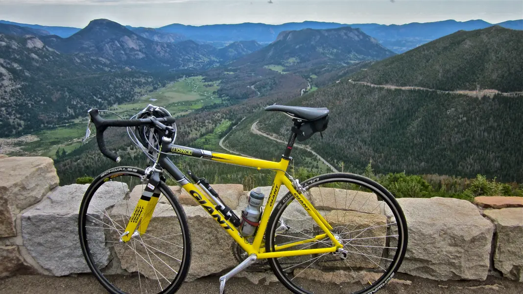

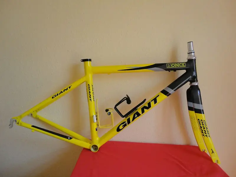

Hi, I am looking for informations about a Giant ONCE...
It is an old but NOS frame.. has any value? ... worth it to build?... If anyone could help me with infos like .. year model, Weight, is it OCR or TCR?.. I am confused..(...and differences), which groupset from that era should I look for, to match with the frame?
Thank you

looking around I found this one very similar but with more hard frame gluing...

It's not glue, it's welding as its aluminium not carbon. Looks Like a TCR Team, they made them for several years, the fork was the big thing that changed between years I think. Looks to be around 1999ish. SOme came with Campag Record, others with Shimano 105.
Most years IIRC Once used Campag.
hamster":1n77vw5n said:
Looks to be around 1999ish. .
I'd go with that, as it has curved forks. The later ones had a straight fork and a 1 1/8 fork steerer. Yours also looks like a standard headset, so would go first generation TCR
... so .. mine (first picture)... TCR moder, late 1999's, curved fork, but BETTER WELDING..?
second picture with hard welding and straight fork is later generation?...make sense?
looking on internet I found some they say tcr or ocr... some other say ''once team''...
all these are the same ? just different year? ...
Anybody has infos about TCR vs OCR version?
which year this bike became a TEAM bike?
any weight info's?
Sorry if asking too much... any link will be welcome..!
