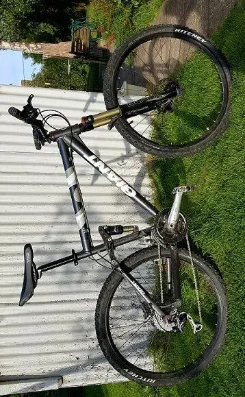

I haven't done much with this for a few weeks, but the Giant thread below gave me nudge! I have a better 9 speed cassette to go on as the middle 3 on this one all slip really badly. A red Rabid headset is in the post from ebay to add a little more colour/sort out the notchy steering. The 105mm stem is getting swapped for an 80mm to see how that feels too.
I may try a 1x9 on this, but still undecided. I am getting a bit of chainsuck on the 32 and need to change it so a NW may be worth a go.
I still think it might look better with shorter forks but haven't seen anything that grabs me in the right colour at the right (for which read low) price. The Marzocchis are nice though, and plush!

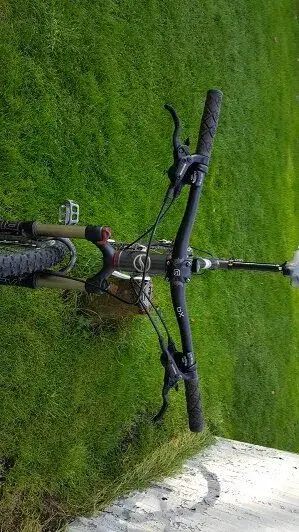

After a year of riding and fiddling I decided to take all the nice bits off Recycled Carrera and put them on this instead....
Forks of a suitable length and slightly less eclectic parts.
(Recycled Carrera is to be repurposed not sure exactly how yet though)

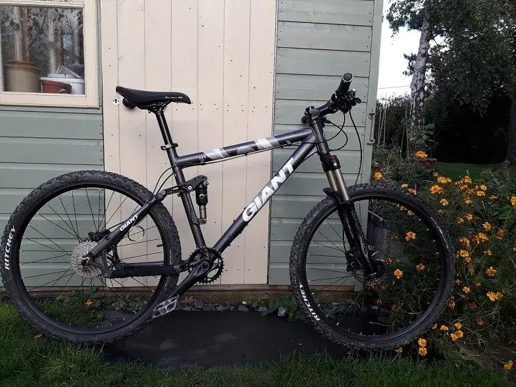

A few further changes...
Swapped to a nicer 2 bolt seat post, some wider and lower rise bars both Brand X, so nothing special but nice enough. Also changed the Syncros 70mm 7 degree rise stem for a Gravity Lite 90mm 6 degree rise.
Front brake hose needs a trim still, but have been contemplating some higher qulaity brakes, but probably not going to bother with that.
