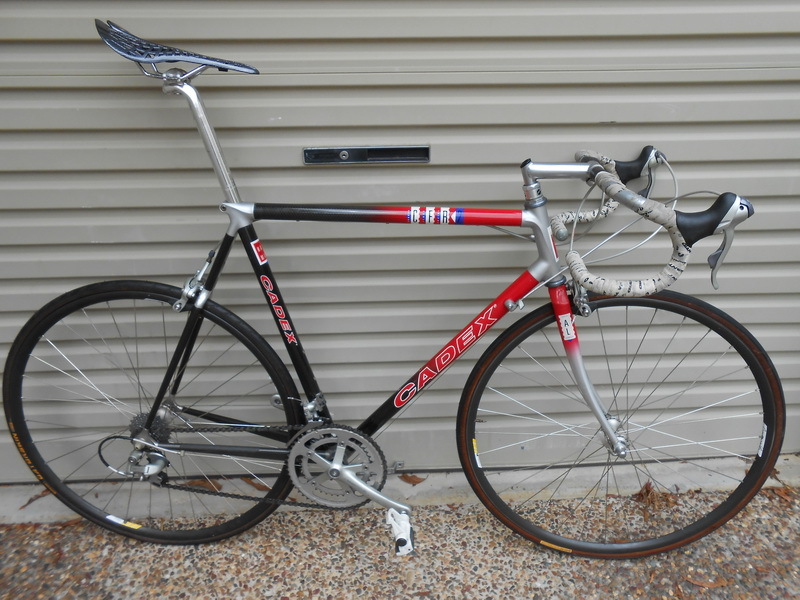

What is the max tire clearance people have experienced with Cadex CFR frame and forks? 28mm on standard rim fit?
Cheers. :)
As above - 28C is absolute max depending on rider weight. If you're larger and/or corner very hard, they will rub. If you're built like a racer, less of an issue :wink:
Re: Re:
I weigh above 200 lbs, and experienced no such problems with 28c tires on my Cadex frame. Great bikes these, cool to see that they seem to have a bit of a following.
