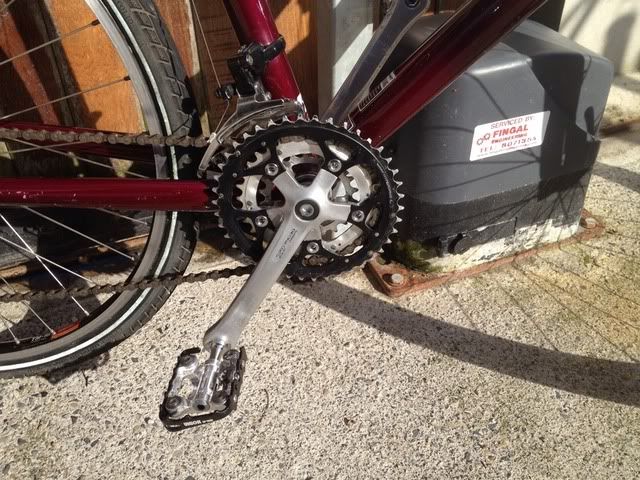

Here's a photo of the bike after about 5 hours of cleaning de greasing tcutting and waxing :-)

Ah good stuff! For the Bottom Bracket, the UN54 is the LX one, and UN72 for XT..... They are readily available on ebay, just do a search for "Shimano UN" and you'll get lots of results. There's a link to an LX below, I'm not sure what length axle you'll need, you might have to pop the current one out to see what length it is.
http://www.ebay.co.uk/itm/Shimano-Botto ... 959wt_1003
I'd go for an XT if you can find the correct size as it will last you longer and it has metal cups on both sides rather that the plastic non drive side on the LX.

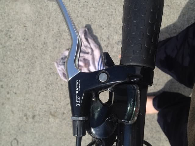

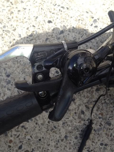

Not a problem matey, with regard to shifters, I'll have a look.... are you sure they're not 3x8 rather than 3x9? Can't tell from the photos, are they shifter brake lever combos?
Hey Ben,
My god when I actually looked they are actually 7 speed shifters, I dont know where I got 9 speed shifters from ??
Here are a couple of photos of them
The return spring seems to be gone on the 7 shifter ie. when you shift up a gear you have to push the shifter back to choose the next gear. the 3 shifter is just cosmetic.

you were spot on with the bottom bracket, easy found now
