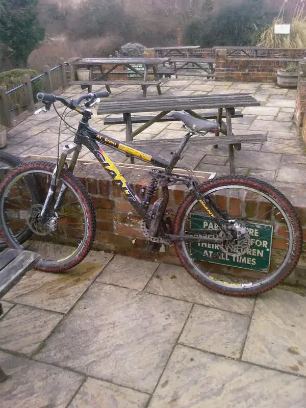

Hi Xizang not entirely sure what you mean but the chaindevice has 3 arms bolting to the frame and the cranks are 4 arm.
Took out on sunday for a ood ride as you can see for the first time, its such a nice ride just proving to be alittle problamatic setting up the chain device but all gremlins will be ironed out soon.

3 arms bolting to the frame would be an ISCG fitting, either Old or '05. I was referring to the crank arms though, my outer plate is for a 5 arm crank, so no good to you :(
Hi xizang maybe you can help me or anyone else with something ive no got much experiance with chain devices and if i have the chain ring on the outside of the crank arms the chain is too far over and the same if i swap the chain ring to the inside the chain is too far over to the middle, any ideas? Cheers
garetha1980":3nrrna1o said:
If i have the chain ring on the outside of the crank arms the chain is too far over and the same if i swap the chain ring to the inside the chain is too far over to the middle, any ideas? Cheers
The chain-ring should be in the middle ring position. How and where is it too far over? The middle position is used for the optimum chain-line for all gears when running 1 ring up front. And because this is how a MRP, e-13 chain device works, by sandwiching the ring between the 2 plates.
