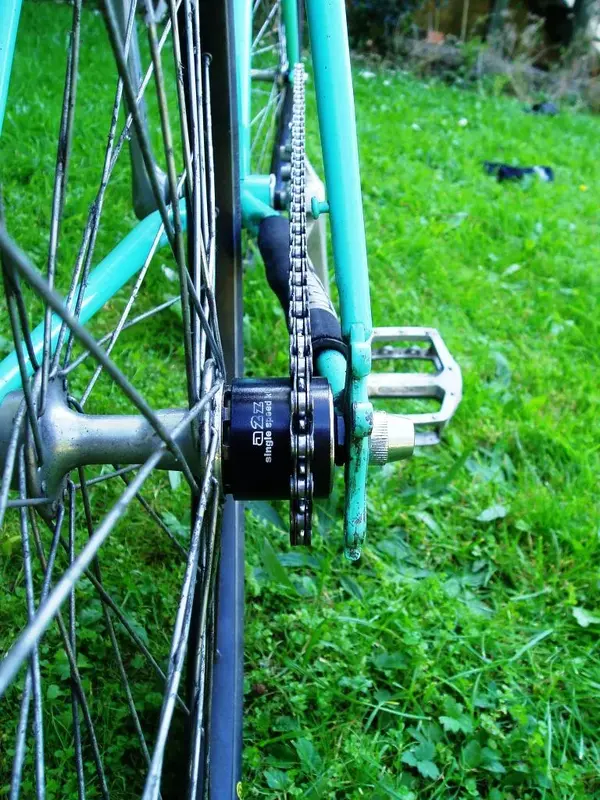

Im using a wooleyhatshop 8 spd one on a 7spd and as mentioned above bin off one of the spacers and you will need one cassette spacer for it to work.
Ditto. Absolutley no problem.
See Pic:
