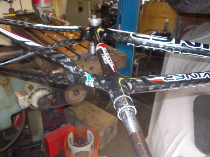

I have stopped for a rest LOL i bought a bike that has little to no maintenance the seat post is well stuck in the carbon frame there is over eight inches of it in there. i am reaming it out with an adjustable reamer. It's getting thin but it will not let go

Carbon frames + wrong 'grease' and there you go. The glue holding the carbon together expands absorbing the grease/ oil/ whatever it used that wasnt the right stuff
given the above
I'm going home to remove seatpost ---- or not... :shock:

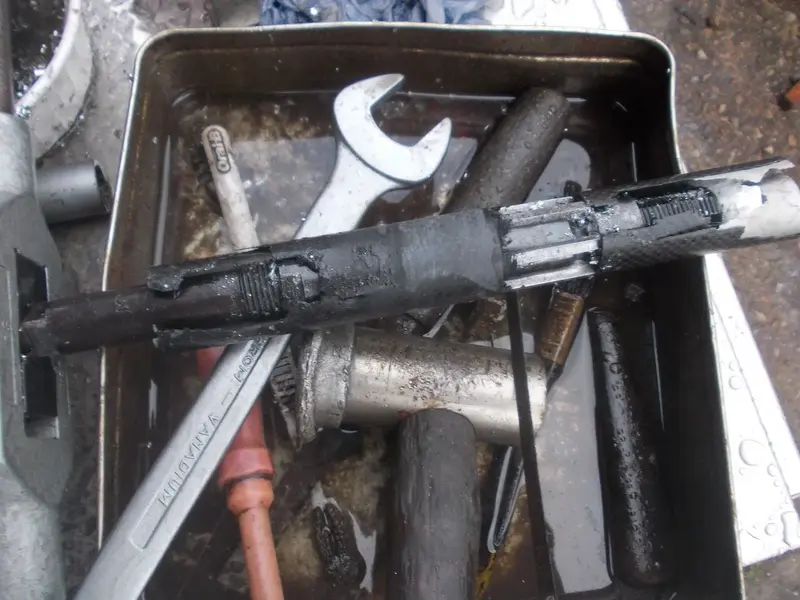

good luck i am worn out had to have two cups of tea wife is not home to take me to the pub an hour later got it out fought me all the way
