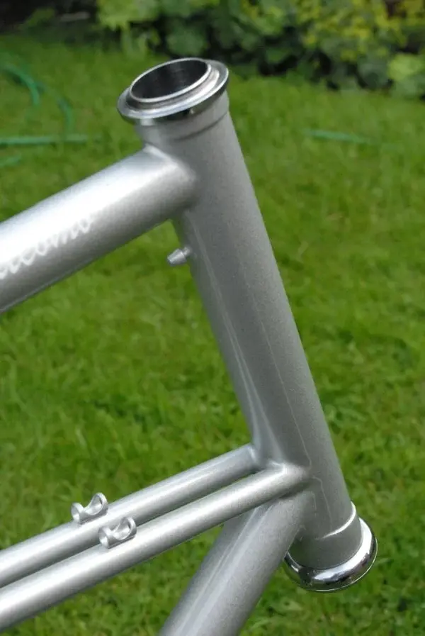

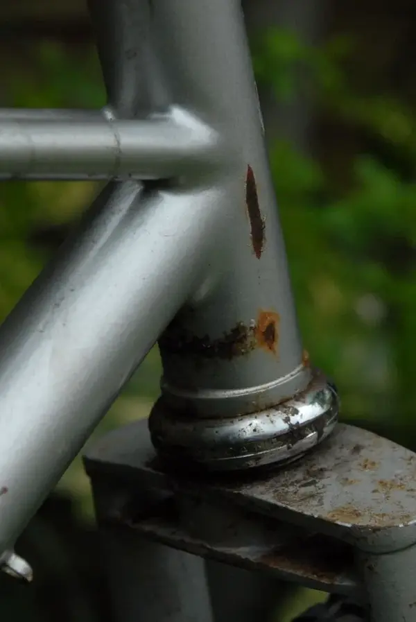

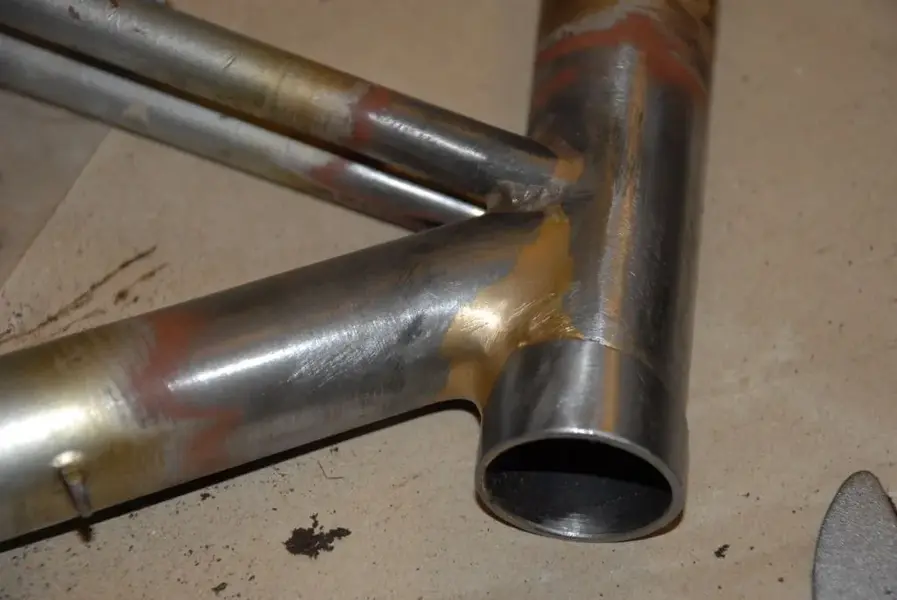

After taking a lot of photos of the unrestored bike and components I set about stripping the bike down.
The biggest structural problem was the large stress crack about half an inch above the bottom of the headtube. This had been caused by the unreinforced headtube being extending about an inch below the downtube, cross-brace and headtube intersection. Whether this extension was the result of an error on Apps original technical drawings of the frame, a frame-builders mistake or some technical issue is not known but it crated a stress raiser where the lower headset insert ended.
The solution was to replace the narrow reinforcing ring at the bottom of the headtube with a much wider one that would cover the crack completely whilst joining to the underside of the downtube fillet.
The fact that such an early and lightly built Reynolds 531ST frame had survived decades of abuse with only one structural failure is testament to the structural integrity of the design and the skill of its frame-builder. As the repair warranted higher fabrication and brazing skills than I possess it was handed over to the skill and expertise of Danson67.
The repaired frame then went off for bead blasting whilst I crossed my fingers that the rusted sections wouldn't become holes and that there weren't any other major issues hiding under the original paint.

That Danson dude gets about and has breathed more life into other wise dead dogs
(Many finely bred pedigrees) than anyone else on Earth !
Great (subtle) repair Mr Wallis,
