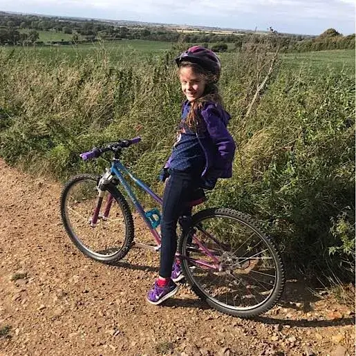

Yup....packing on the lbs doesnt help with handling :lol: I have a few sets of Mani forks, one with springs but even experimetnting with 40 Durometer elastomers, they were not doing much for my 9yr old until i started to drill a few holes in them. They work perfectly now and you can see the confidence that inspires, plus its much safer as they can attack obstacles at odd angles sometimes and the sus thankfully allows the wheel to compress enough to go over it safely. Her bike is crazy light, Ti steerer, alloy bolts, Pauls, elastomers ( lighter ) and she absolutely love it. :mrgreen:
