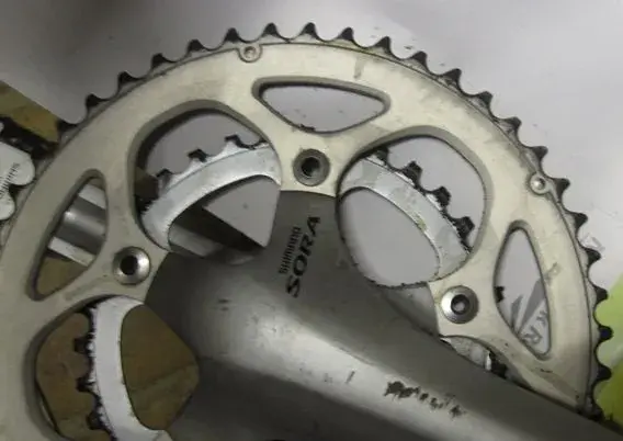

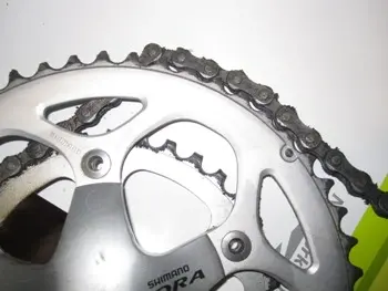

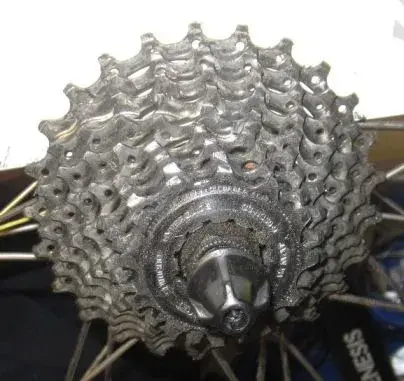

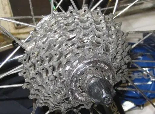

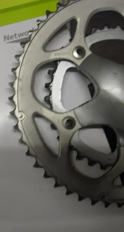

Well using the ruler trick, I checked the chain a couple of times and the lenght for 12 links was consistently around 11.6inches. Its the right chain as it says 9 speed on it.
I also took some pics of the front and rear cogs (attached) and tried to make sure that the rear derailleur was not bent.
I would appreciate any opinions on the quality of the cogs/ cassette

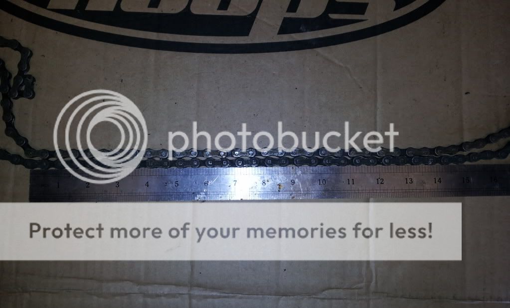

Hopefully the below photo will highlight my point.
The chain closest to the ruler is a 7 speed chain with just over 1% wear according to a park chain gauge, you will notice clearly the amount of stretch on the chain as the 12 inch mark is no where near a link pin and in that short length of chain the stretch is substantial.
The chain above that is a 9 speed with less than 0.75% stretch, it’s a bit difficult to tell from the photo but the 12 inch mark of the ruler doesn’t align with a pin centre either (on a new chain it would).
But the picture shows pretty well the effect of stretch don’t you think, just look how quickly the chain links stop being aligned!

Well, you must have measured over 11.5 links (23 pitches) but straight away you have 0.10" of wear over that distance, which is getting on for 1% elongation (0.9% actually) so time for a new chain, I reckon.
That big chainring looks well hooked too, they get like that when you run a very worn chain on them and the greater effective length of the chain forces it to run higher on the teeth.
I second Andy's opinion on the chainrings. Also, several of the rear cogs are clearly worn. The cutouts (not sure about the correct word) between the teeth are oval instead of round.
Time for a completely new drivetrain.

A new outer chainring should suffice, but I'd give the inner one a good once-over with degreaser as well.
Judging by the amount of dirt on the rear axle and the general condition of the crankset and cassette, I'd say that the seller "forgot" a digit when he mentioned the mileage. I'm also pretty sure the bike has been used a lot in the rain and never had any proper maintenance.
