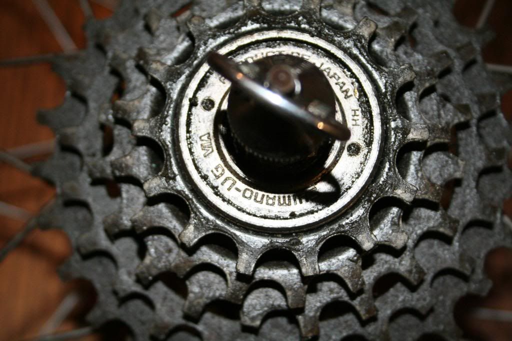

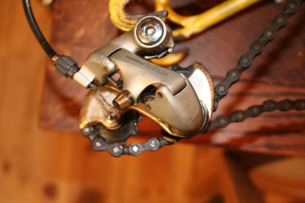

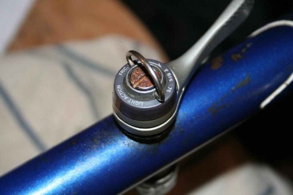

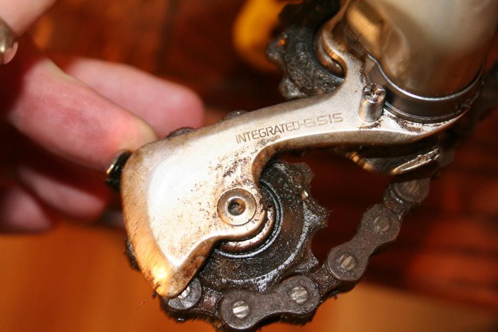

Got a few pics now which I've put a little further below
The shifter clearly says 7s so I'd assume 7 speed shifter. The derailleur says integrated 8, does this mean I've got a mismatching 8 speed derailleur is it that the design name?
I'm thinking of widening the drops to 130mm (Argos will do the work), if I do this I'll need to put 8 speed on it though.
The build looks like a bitsa (bits-of-this, bits of that) Unusual that someone would build a 120mm OLN rear end on a frame in 1986 when the norm was 126mm - Argos charge £30 for resetting a frame to 130mm. The rear wheel / hub is probably older than 86 too. The Shimano 105 parts look like 1055 series which is 1990-ish - if you have 7 clicks on the shifter then it'll work with 8 speed.
The Hub looks like a Nuovo Tipo with a Record quick release skewer......
They became hard to sell in the mid 70's (if you were in a bike shop) as they had circular holes rather that oval holes of the Record hubs which were seen as much more desirable.......
Shaun
5 and 6 speed generally had 5.5mm gear pitch, whereas 7 speed is 5mm. So you are likely to have trouble with indexing. Frankly with cogs that far apart friction is fine.
