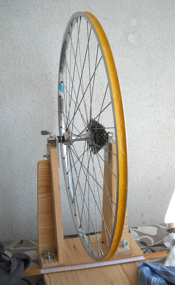

Finally had some time to rebuild my wheels. First had to built some truing stand. Got some wood and started cutting.
After some work it starts to look the part...
Here it is with the radial and lateral gauge completed.

Awesome truing stand, and its adjustable! Just recieved my wheels for my build today and nearly have most of the parts so i'll update my thread soon.

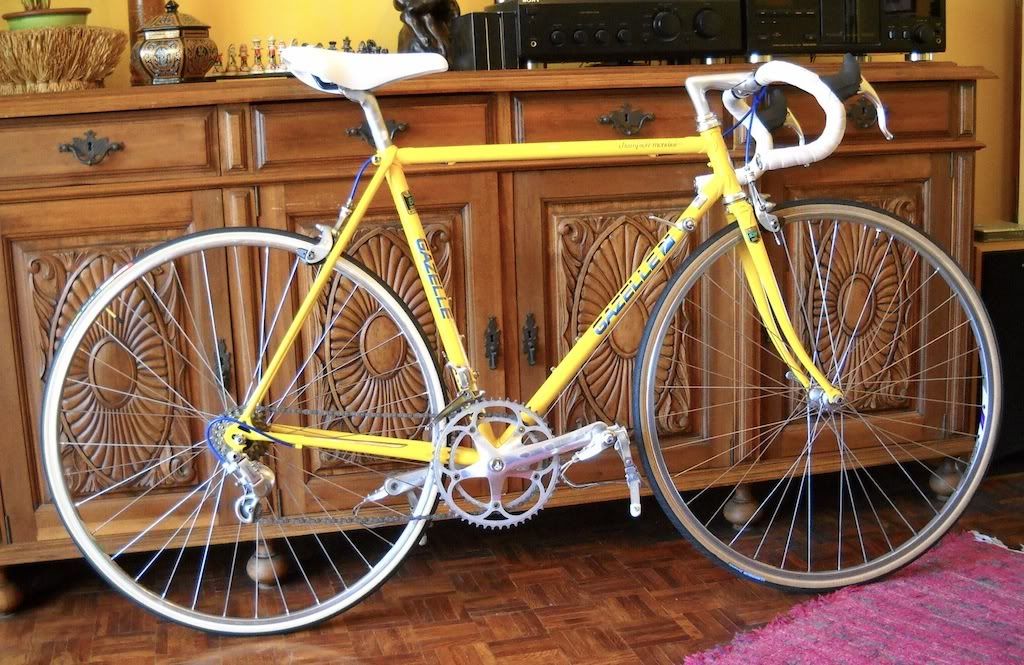

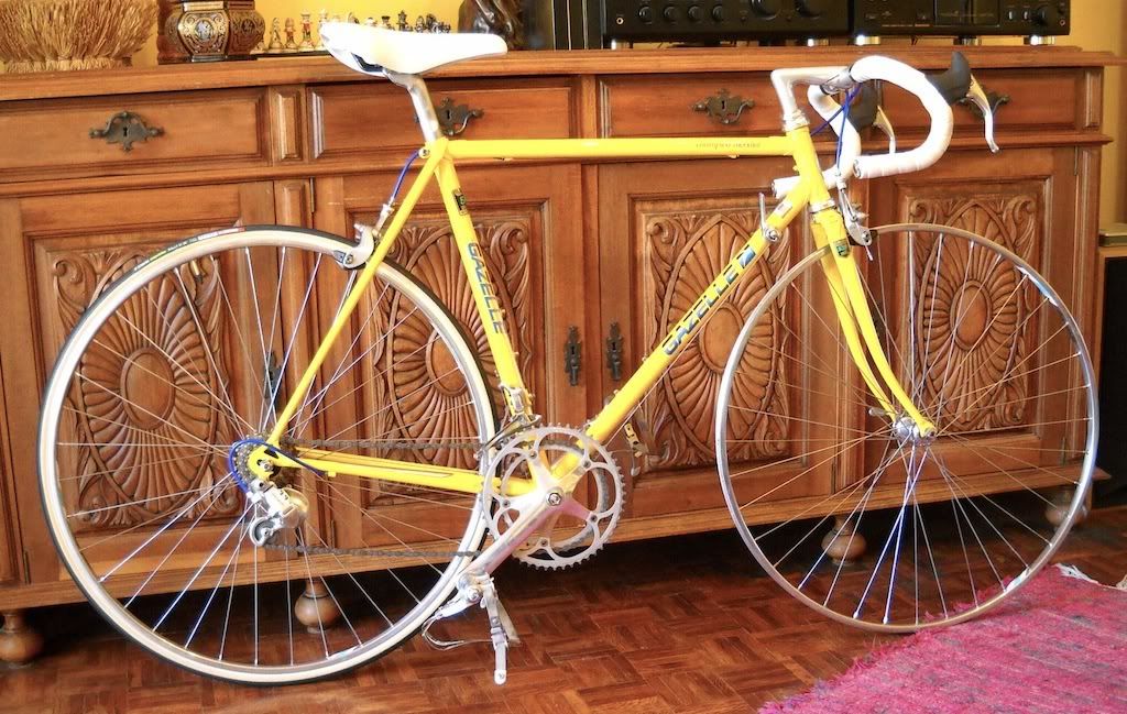

This morning I've rechecked things again, applied more tension and rechecked again. Screw the freewheel back again. Applied some rim tape and the new tubular.
Here "she" is with the new rear wheel.
Now onto the front wheel! 8)

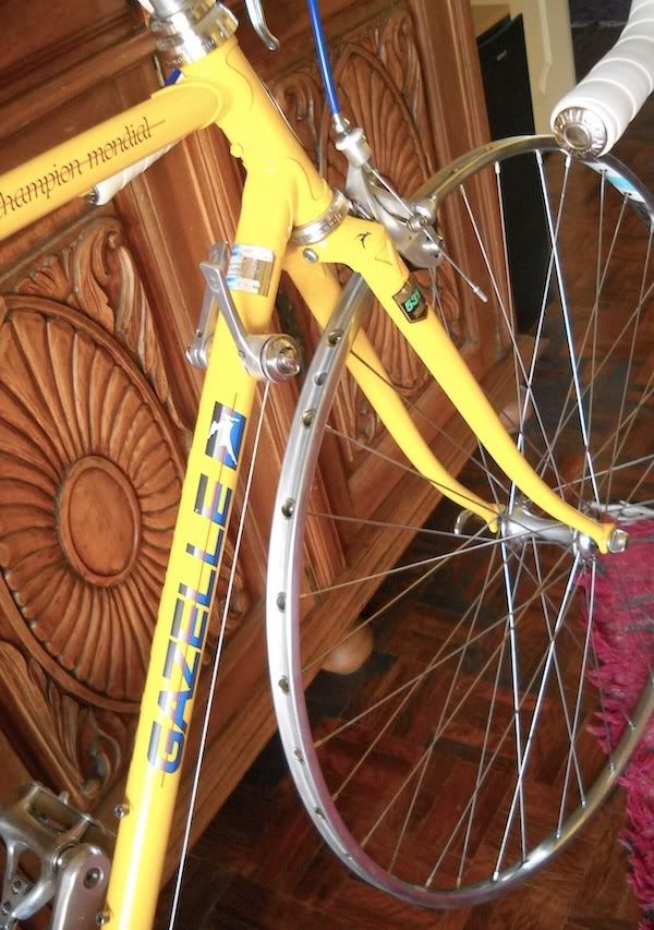

Did the front wheel today.
I'll check it again tomorrow, do some final tensioning, truing and check one last time. Then I just have to glue the tubular and I'm done.
Can't wait to take it out again! :D
