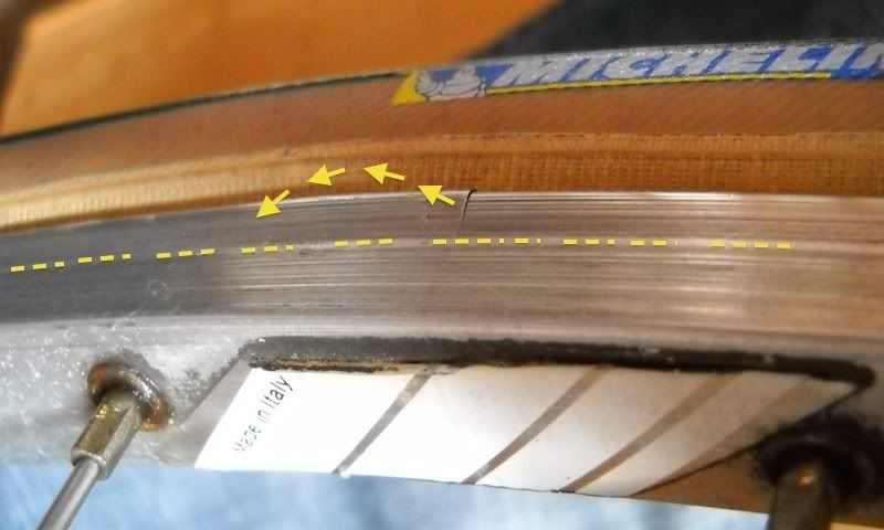

I was out again today and half way through my ride I stopped to admire the scenery, stretch and drink some water. I picked up the front wheel to see if it was still true. No problems there. Then did the same for the rear. Picked it up, put some spin to it and to my surprise spotted a strange "bump" on the rim's edge where it meets the tyre. At first I thought I'd hit something that bent the rim outwards. When I got home I've deflated the tyre and tried to bend the rim back in. After putting some pressure on the tyre the "bump" returned. It seems the old rim wall is collapsing. After all these years the rim's wall just got too thin and can no longer support the tyre's pressure. You can actually see a "line" along which the rim is bending outward.

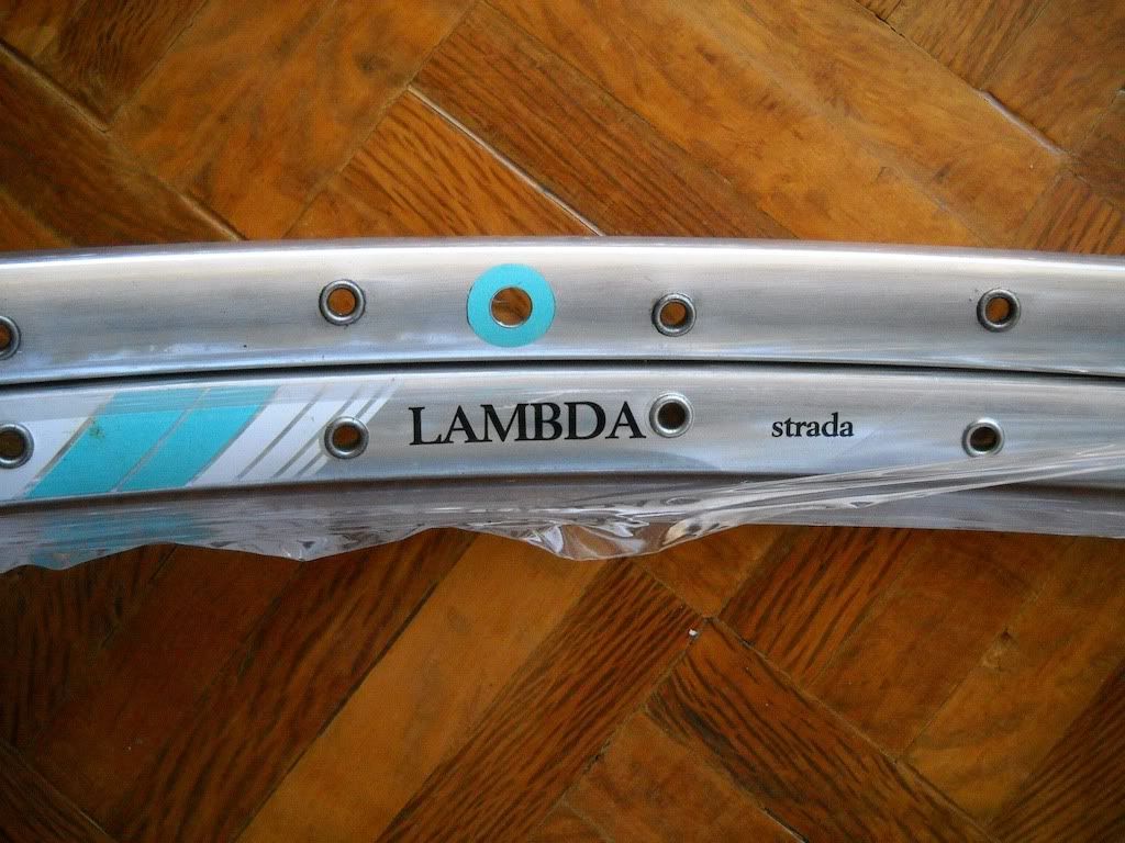

I suppose I just have to get some new rims... where am I going to find a pair of NOS lambda clincher rims now?... :(
well spotted, happened to a friend of mine years ago, rim exploded up a country road 40 miles from home, before mobile phones etc.
