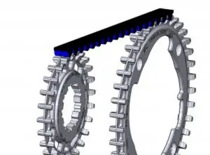

Been looking into this for ages and was about to commit and buy a set for an Orange P7 frame I had but then heard about the new Centre track system.
Since I got the Sawyer I have been waiting to get a new Centre track system for it as the frame is split at the back which will allow me to fit the belt without any issues
Last date I saw for the new system was around Christmas so hopefully get a set for the Sawyer and see how it goes :)
