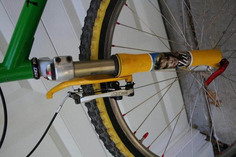

Poor Farrah.
"I do know that this bike was "pre Serrota" so it was built in Saratoga, NY by Chris Chance."
I think hes a little confused there...
