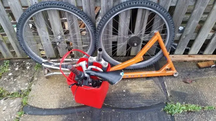

This is my project :)
It's all original parts except one bush I will have to have remade and the grips. I'm going to do some touching up painting but mostly leave it as it is.
I am new to this so, if anyone has any advice, I am all ears.

Cool project, you don't see many Nishiki FS3's around.

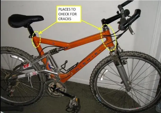

Saying that, best check for cracks in the frame, mainly the head tube and seat tube junctions. They were a bit notorious for failing there.
Will look forward to more updates :)
Oh yes, very nice. Plenty of love here for the Nishikis ans anything Cunningham/Mantis, too.
Anything with square tubing gets my vote ( I have the steel/aluminium Nishiki ACX).
Looks to be in good condition. As said previously, they are notorious for cracking, so check here often:
