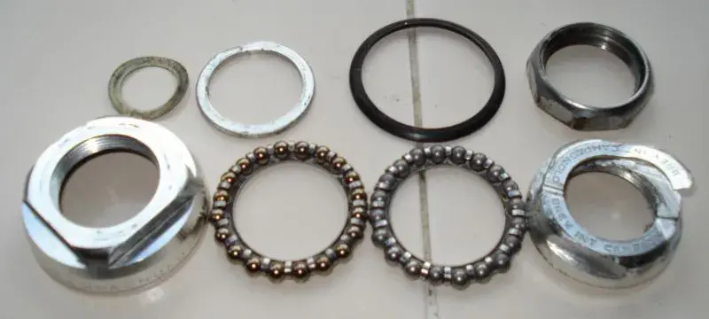

Strange how the bearing clip on the left is still like new after 20 years whereas the one on the right needs replacing. The other locknut is steel and a temporary measure until I can get a new shiny one. Mysterious small washer was found at the bottom of the steerer.

You mean the thin bendy washer, was it found under the bottom race nestled against the fork crown ?
Shaun
Shaun
No. It was actually inside the steerer. The brake bolt was stopping it from dropping out. It's got me wondering whether it's come off the quill stem.
that sounds quite likely - it's too small to have anything to do with the headset. well done getting it all off - I guess the only damage was to the lockring?
That's right Foz. And thanks for your advice. I had to cut the locknut diagonally and very carefully using a junior hacksaw. The blade just touched the steerer threads in a few places but no harm was done. I then opened it up using a hammer and screwdriver. Thankfully, the alloy was very soft and easy to cut. The rest of the headset was basically fine and is back on the bike. The crown cone is rather pitted though. Hardly surprising - it must have about 30,000 miles under its belt.
