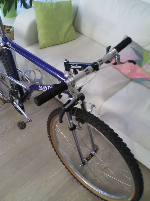

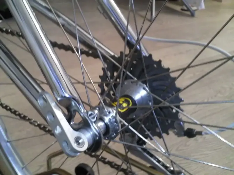

The main aim was to have the matching couple of hubs on an exposition bike, so very few kilometres made with this bike...
The problem is that the flange has cracked without riding it :cry:
The ones I've seen fail were always cross laced, so radial laced would be even worse most likely. I once had a shimano RX100 hub which I radial laced, which detonated the flanges off of, when the wheel fell over in my basement.
This was the uncracked couple of hubs...
