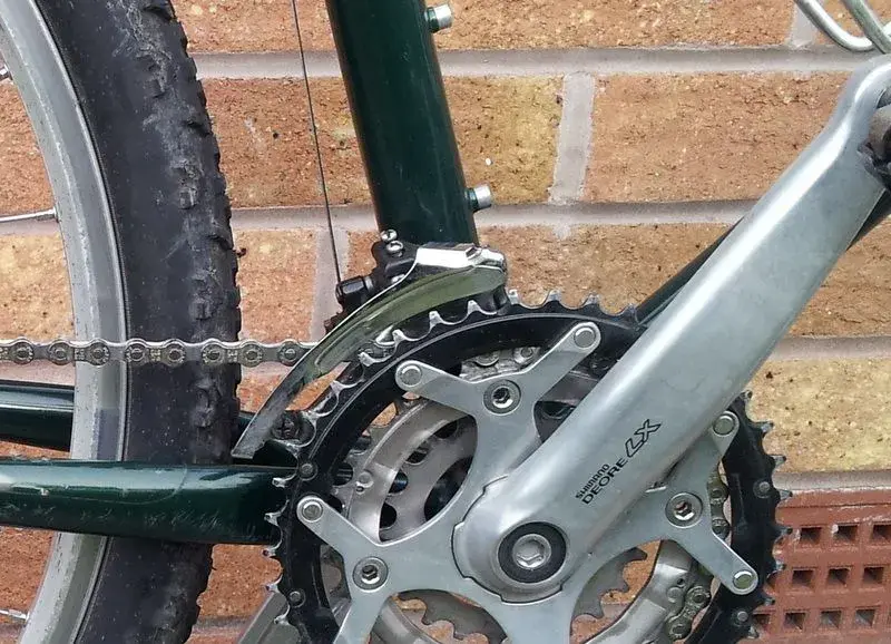

You can use a high band style, but you may have to space out your bottle cage to clear the band ( depends on cage).
Usually 31.8mm band bottom swing, top pull like an m739 is what is fitted from factory, but I have successfully fitted a high band top pull m900 so either way. What tooth count is the big ring?
