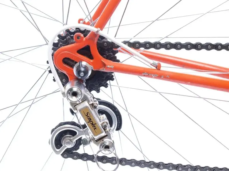

It's not the guide so much as the Meral has the same one on the underside of the rear stay but the little ring on the top of the dropout for routing the outer through that I've not seen before. And having not seen it before I'm hoping it will help identify the frame maker.

Long Campag(?) dropouts might say about mid-'70s, although the top tube cable guides might say 'a bit later'.
French, Red, '70s... Lejeune? ...but anyone can paint a frame red, of course.
Having had a bit more of a dig about I think torqueless may be onto something. I found this Lejuene on the internet that has a similar cable guide.

There's no evidence of decals anywhere so these were taken off very well but this doesn't help with identification at all. All I can say is that it is French, I'm pretty certain it's 531 and so far the most likely candidate for builder so far is Lejuene but if anyone knows better please tell me.
