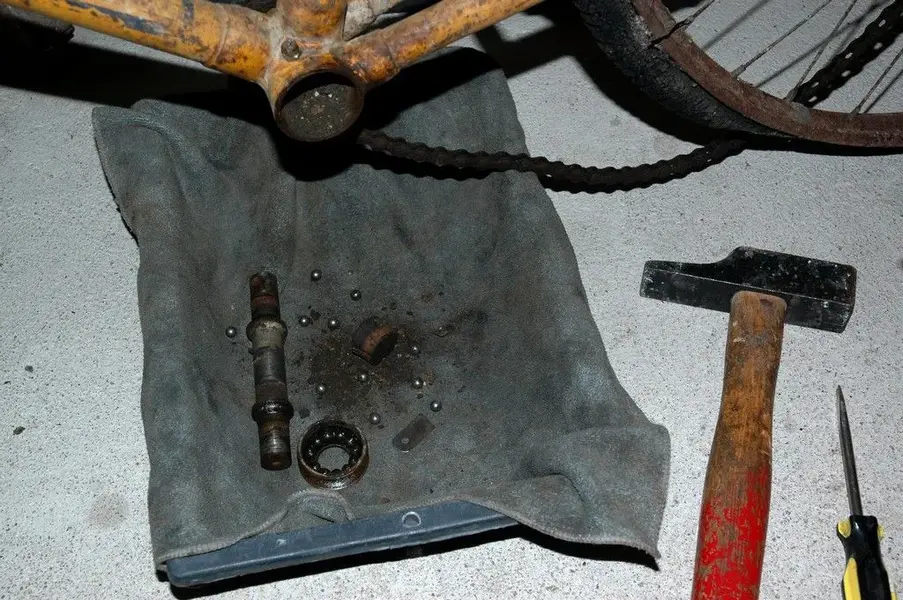

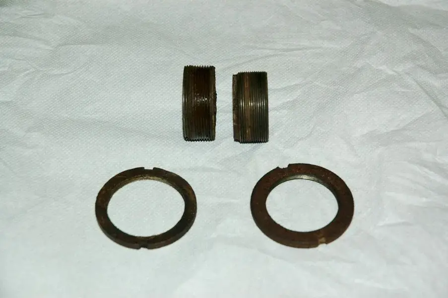

Back to business. I'm in the process of the chainset transplant.
Initially I thought it would be an easy crank swap, but foolish of me to think so due to different requirements in spindle length and symmetry off-set for the "new" crank. Forced to dig deeper and find a solution the BB had to come out for a full spindle swap. With some surprises...
- the NDS cup lockring came off easy enough, but the cup could only be removed via one indentation for a dot punch. More hammering....
- Once the NDS cup was off, there was usual amount of dried grime and shit in the shell, but also a cork (to plug the seat-tiube) and a broken bit of hacksaw. WTF :!: :o . I'm underlining now, it's not my hacksaw blade, but I'm glad it's out since I can't tolerate rattly frames.
- the cup diameter is larger than the old 35mm French diameter, and closer to the obsolete oversized Chater Lea. This really throws the spanner in the works as the intention was to move over the other cups to be sure the entire "new" chainset would work.

Thankfully St. Sheldon is guiding me along, and I can confirm that both bottom brackets are:
NDS thread - turn to the left to remove. ie. same as BSA/ISO standard.
DS thread - turn to the left to remove. ie. opposite to BSA/ISO standard.
I've had to re-arrange my workshop bench to do the old "put the fixed cup in the vice and turn the frame" trick which was a major hassle. Romantic images of descending the Col de Croix de Fer on it where quickly replaced with throwing the whole damn lot from the summit.
The cup diameters are beating me. The larger ones from the frame in Lot #2 (which I'm concentrating on) are really weird and do not round up properly to either a whole metric figure nor an imperial one. The ball bearing sizes are the same 4/16" = 1/4" between the bottom brackets.
The only way out I see is to do a spindle swap and use the oversized cups but right now I know for fact this will screw up the chain line - the cranks are completely different beasts. To add more fuel to the fire, the bearing butt locations on the spindles are close but not the same. No markings on the spindles either. :facepalm: .
I'm going to have more wine and chill to Nina Simone to find a way forward because right now I feel I've entered a French vintage bottom bracket world of pain.

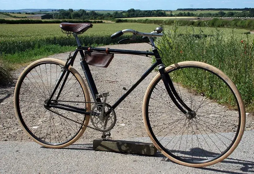

The wikipedia entry for De Dion - Bouton contains no mention whatsoever about bicycles. The single best write
up is here: https://oldbike.eu/1913-velo-de-dion-bouton/
The article is well worth a read - this was the tipping point for me to persevere. I simply couldn't pass on this one.
