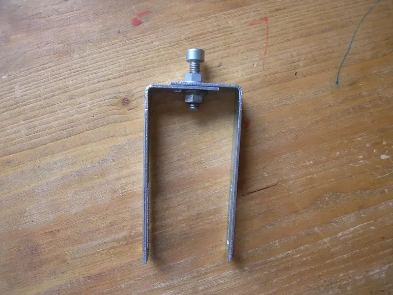

I think I'm going to see if I can make my own DIY c-record dust cap puller, then I should be able to take the locknut and cone off the non-drive side and slide the axle out like you say.
OK, after 5 minutes rummaging in the bottom of my tool box, I've found a few bits which I think I can use to make my own dust cap puller! I still need to measure, bend, file, and maybe find a longer screw, but at the moment I think it looks promising!

Hang on. I have the Dura Ace 2-dog freewheel remover and you are welcome to borrow it. Can you post a picture of the offending set up so I can try to judge if the remover will get it off?
