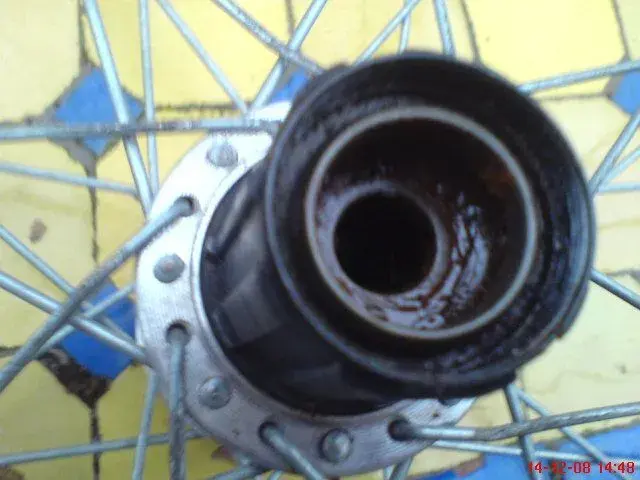

Thought i would replace my knackered freehub with a new one today, quick job i thought :( . How do you get the old one off i have stripped the axle and bearings out of the hub and all thats left is the freehub which refuses to budge. Its an Acera X Parralax hub 7 Speed. What am i doing wrong? Please help.

Indeed a 10 mm Allenkey is needed.
Watch out you find the right freehub, there is a difference in the bearringthingheight in a few shimano hub types.
Definitely a 10mm Allen key. I went through this a year or so ago, even posting photos to show that the inside was circular, not hex shaped. I had to eat my words.
