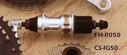

Now if it is a cassette hub then I believe there are 2 ways of holding the cassette onto the body, the more common lock ring which is where the internal diameter of the cassette body is threaded, the cassette is slid onto the splined section and a lock ring screws into the threaded internal diameter of the body.
The second type is not used thesedays and relies on the external diameter of the cassette body being threaded, and the smallest gear screws onto it compacting the rest of the set onto the splined section.
Without more info from you it will be difficult to ID.

I have just had my bike shop back on the phone they have never seen one like it. Pants. I shall get the hub back and post a picture of it on here.

and FH-R050 is still the only 'clutch' type and STX/Alivio level
