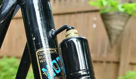

More involved craft method with the lovely tapered Takahashi ones:
  • -Piece of steel flat about 6" long with a slot cut in one end.
    -Make the slot the right size to fit half way down the tapered shaft.
    -Rest the other end of the flat onto the other seatstay.
    -Weight of the flat keeps the peg in place as you braze it.
Quick and easy production method with the cheaper 'bent nail' style ones (or the Takahashi):
  • -Cut a small length of brazing rod, set this aside on the bench
    -Hold the peg with some needle-nosed locking pliers, and dip it into the flux paste to coat the end
    -Dab the fluxed end of the peg onto the rod clipping to pick it up
    -Hold the peg on the tube in position
    -Heat the lot while pressing down on the rod to stop it moving as the water boils out of the flux.
    -As it gets up to heat, you'll feel it melt.
    -Push down and position the peg and remove the heat.
For both versions and methods, it's well worth filing the underside of the peg to fit the tube profile.
This not only looks better, and keeps it in line, but it helps to stop the peg trying to turn as you braze.
All the best,

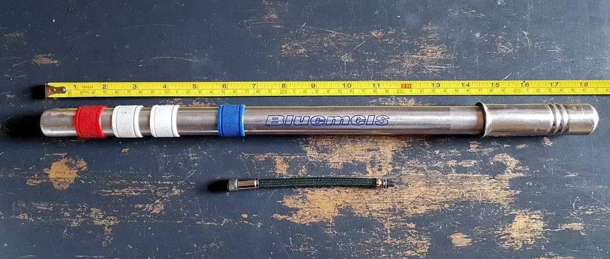

what about the alloy ones that have the red and blue rubber bands on them? I have one of those and it works well and is about 40 yrs old
Bluemels?:
If you can find a long un-dented one they do polish up beautifully with a bit of T-Cut.

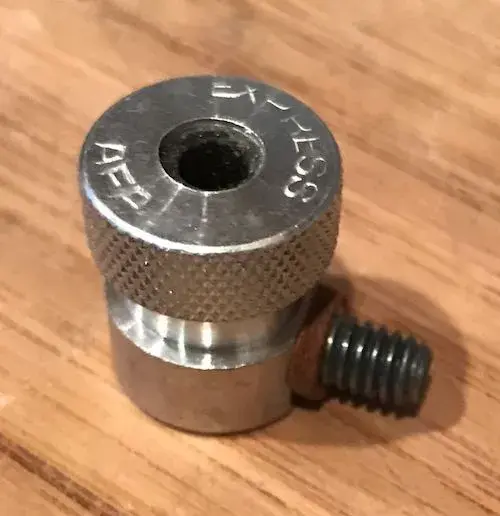

Fit one of these and you don't need the hose:
