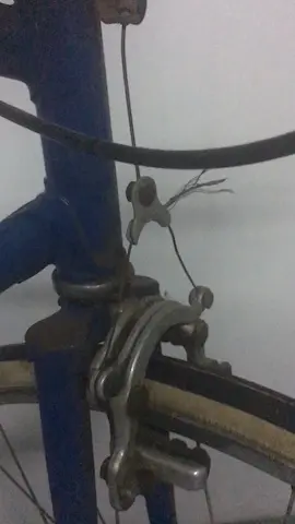

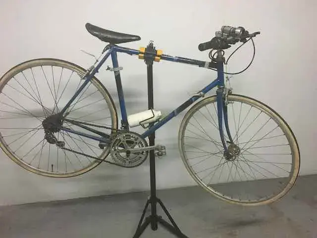

Can anyone help me please to identify this frame. It has what seems to be “RGB” initials.
Handlebars GUID
Brakes MAFAC RACER
Crank Stronlight
Cassette 5speed Maillard Sachs
I appreciate if anyone help me on this.
We need sharp close up pictures of frame details.

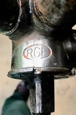

RGB would be maker of the bottom bracket shell used by many hundreds of frame builders.

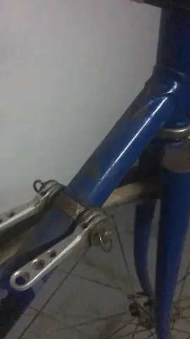

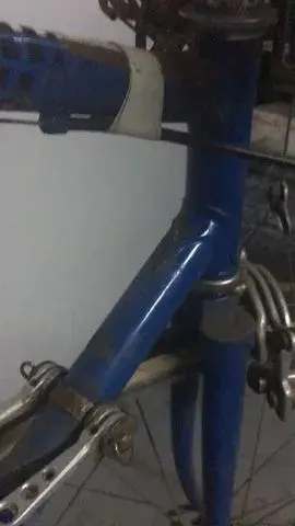

Some more pictures.

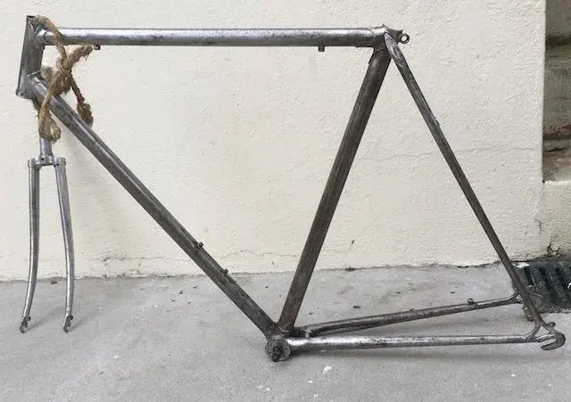

. The Initials RGF however refer to Raccord Gargette Freres who were the manufacturers of the Bottom bracket shell. I did think that it could even be a Johnny Berry frame but maybe it is a bit too modern?
Thanks for the comment. I really would like to know just for the raison that I'm going to restore it. Just a question if it was a Johny Berry frame it should have a serial number? the only number I discover was 56 in the frame and a strange number and letters in the fork....
Question is.. where did you find the bike? Your screen name suggests you might be posting from Portugal or Spain, or South America, which countries have their own indigenous framebuilders.. which I for one know very little about.
I've never heard of Piazza dropouts. Looks like a nice enough late '60s-early '70s(?) road frame, anyway.
