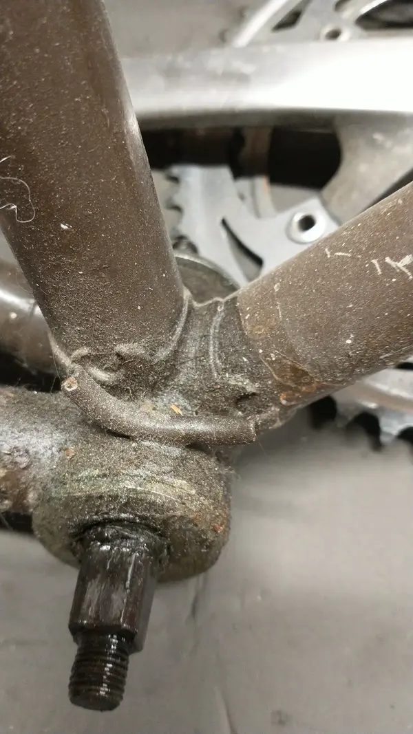

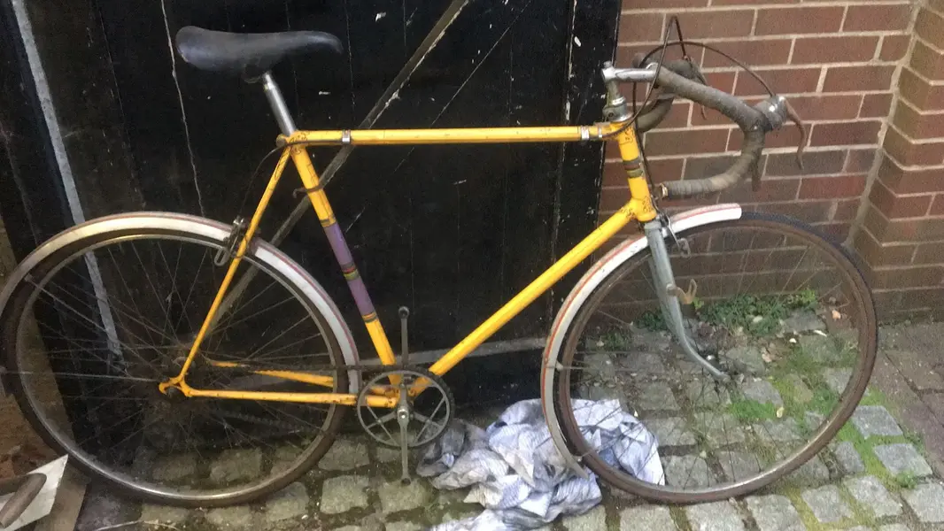

I recently acquired another frame for my collection and would love to restore it with the correct stickers etc..

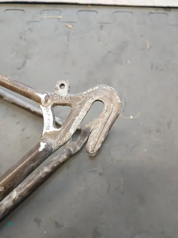

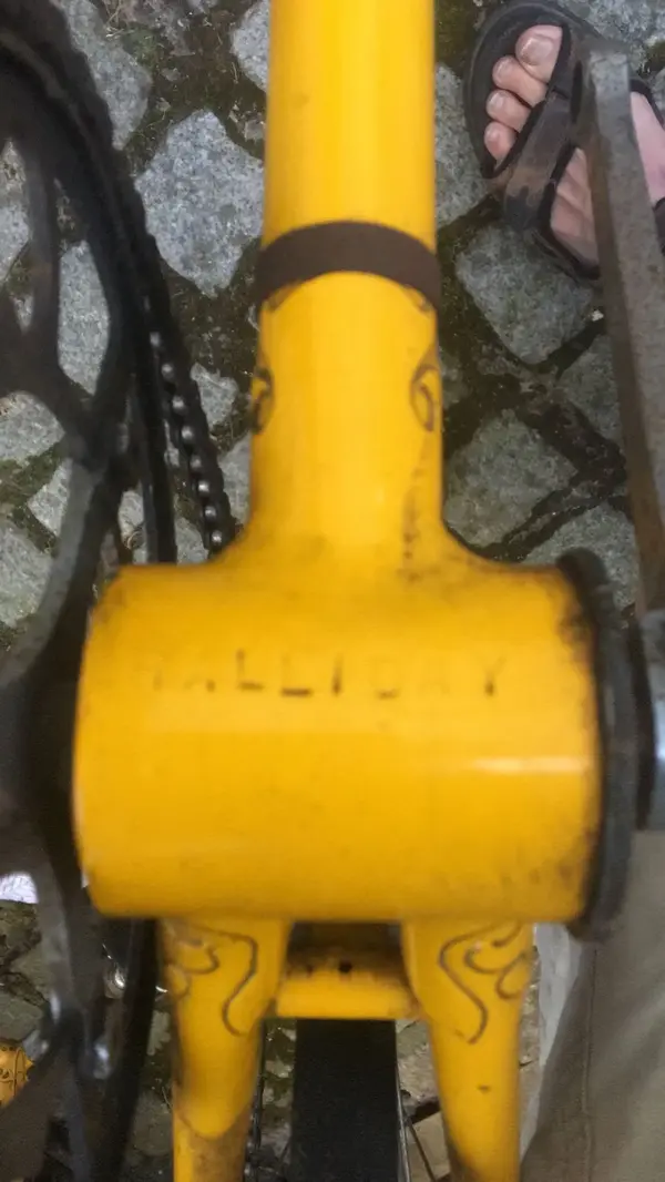

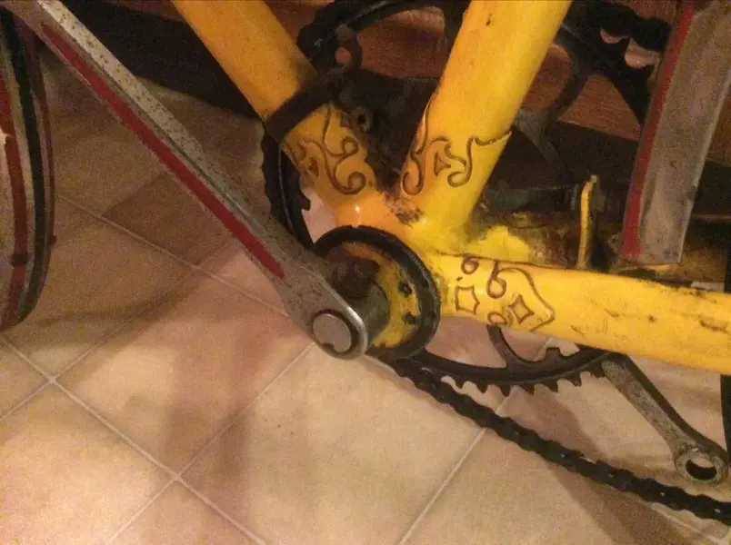

I have been hunting and the frames and numbers, those that look closest to me are Claud butler but nothing seems to fit the bill exactly IMG_20210829_194509885.webp IMG-20210829-WA0009.webp IMG_20210831_171331621.webp IMG-20210829-WA0010.webp . I could be way off the mark and it could be a Carlton or something else. The frame and fork numbers match 11545.
And help would be much appreciated
Thanks, Stuart
First thoughts are a 1961 Holdsworthy Claud Butler Cordon Bleu. Top of the range, changed those nice seat stay tops the next year (I’ve got a ‘62)

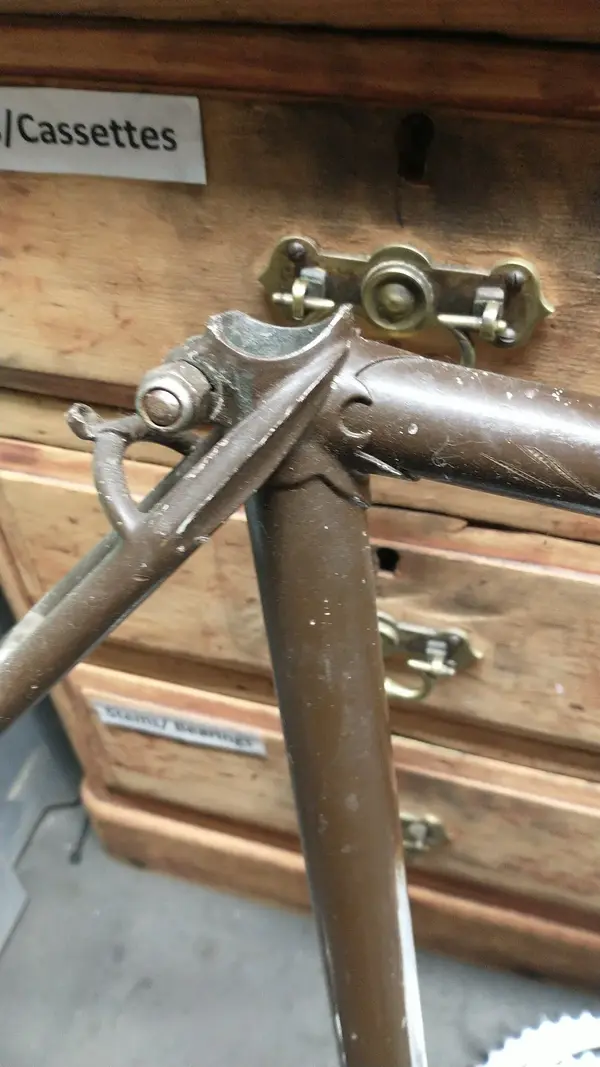

Although the rear hanger is more like a 1959+ Claud European as that had cantilever brakes. Do the forks or stays have canti studs? And show us a close up of the rear drop outs please.

The awful brown paint (currently removing) was leaning me towards a Carlton IMG_20210901_184149415.webp IMG_20210901_184218066.webp
Ok so it’s got the correct dropouts and the forks aren’t canti. Maybe the rear hanger was a customer request or maybe a later addition, but everything else says 1960/1961 Cordon Bleu.

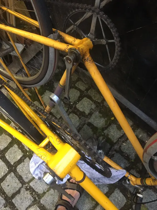

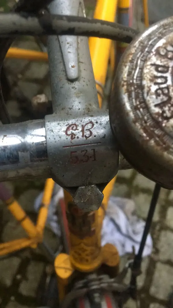

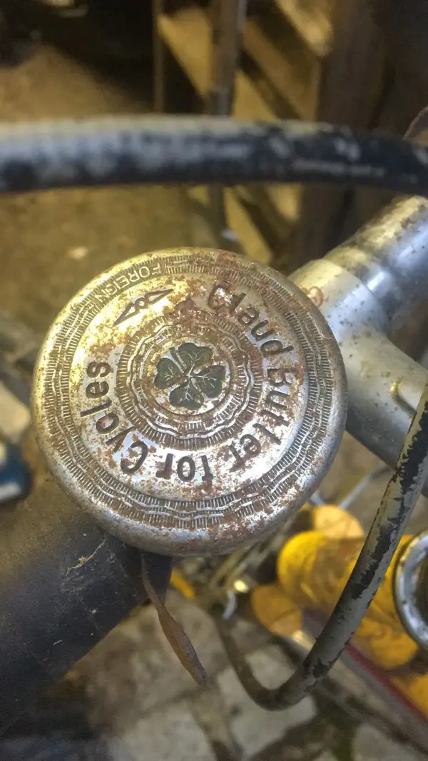

I post a picture of Bert Halliday. My Club mate and friend has the wheel stand in his garage and a frame jig, although he is not 100% certain the later came out the factory.
That's quite fantastic! I’ve never seen a Claud with those bi-lams before.
Any chance that bell is for sale?
Or even the whole bike?
I have asked about the bell🤔. Richard intends to join the group, he thinks that he may have some other CB treasures that may be of interest.
