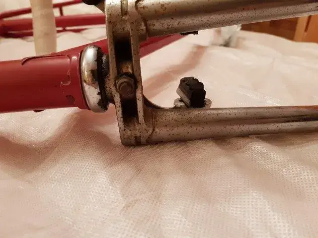

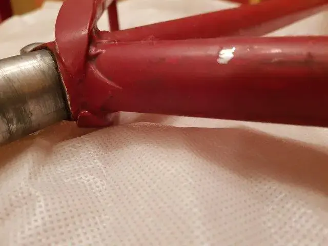

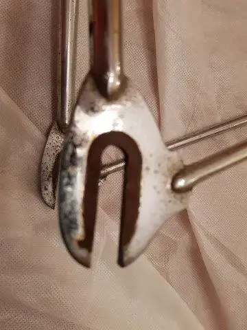

I did post some of these pictures in the Holdsworth frame thread but as it it not confirmed as one i thought better post it seperately. Thanks to those who helped there.
I believe it is a track and path frame. Nervex lugs and campag dropouts. Round forks and stays. Straight undrilled rear bridge. High bottom bracket. Frame number 67135 but fork number 65135. Any help much appreciated. Thanks

Frame numbers do very much fit in with Claud Butler Holdsworth numbers 1975/1976. Just that the details don't all add up.

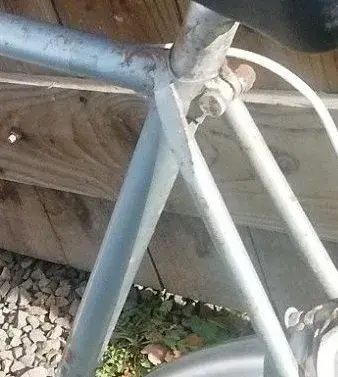

If it wasn't for the rear facing track/sprint drop-outs & date I would say a Cordon Bleu, as the lugs and semi-wrap over stays match, but the last Cordon Bleu frame sets were advertised in 1970. maybe its a one off?
ps I think the forks need to be discounted as part of a frame set, although that's not to say it didn't start off with them.

Ps, this 1964 Cordon Bleu is getting collected by DHL on Monday, so when I get it (probably Wednesday/Thursday) I can post some better lug/stay photos.)
