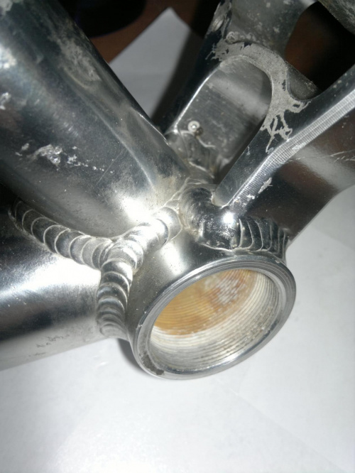

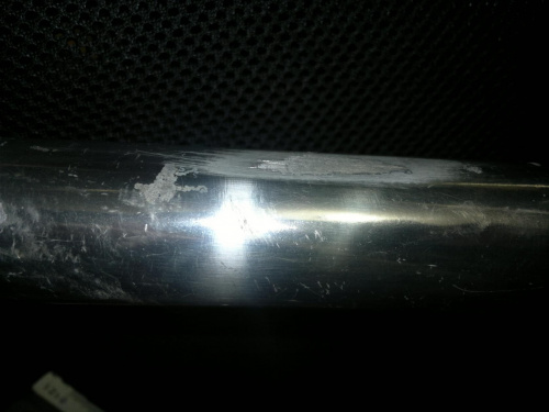

Hi folks, I have just got that frame...I see there is very thin layer of "laquier" and its damage in some places...
should I do somethink with it or is OK to use the frame as it is ?
Is it laquier , a clear laquier I guess, right ?
BTW, frames seems to be very thin, the sound when you knock in it, is way different than my recet bike GT...I wonder what the weight difference is...
Yeah start of corrosion through damaged clear coat It'll be a while before it starts any serious eating into the aluminium ! Cosmetically it doesn't look great ! I'd be inclined to sand and polish to stop the spreading.
what way to clean it ? by paper, chemicals, or sanding ? Its very thin alu, so I think sanding is not good here.
