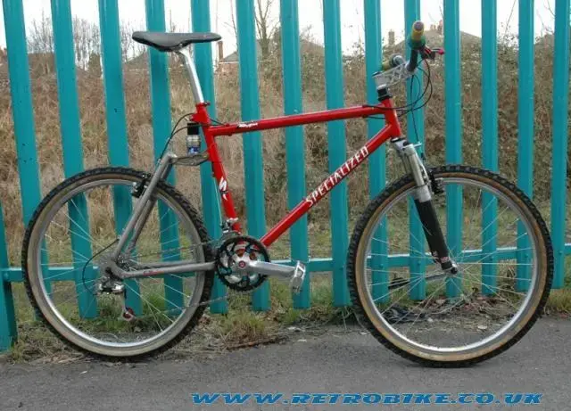

anyone got any idea what pressure the fox alps 5 should be set at on the rear of the specialized FSR
not been able to find anything on the net ??
If I recall correctly you want to set the pressure so that you have ~25% sag. I run my '95 with ~7mm of sag.

Do we think this bike is set up with too little sag then?
Mr K
That's hard to say without seeing it with a rider on board. In lieu of installing an O-ring to evaluate sag consider a zip-tie instead. Push the zip-tie down against the shock seal, gently climb on board with your typical riding gear, evenly weight the bike between saddle and handlebar, gently dismount and then measure the distance the zip-tie has traveled along the shock shaft. For this particular bike and shock the magic number seems to be ~7/8mm. If this isn't the number you get add or subtract air pressure appropriately and repeat the above process.
