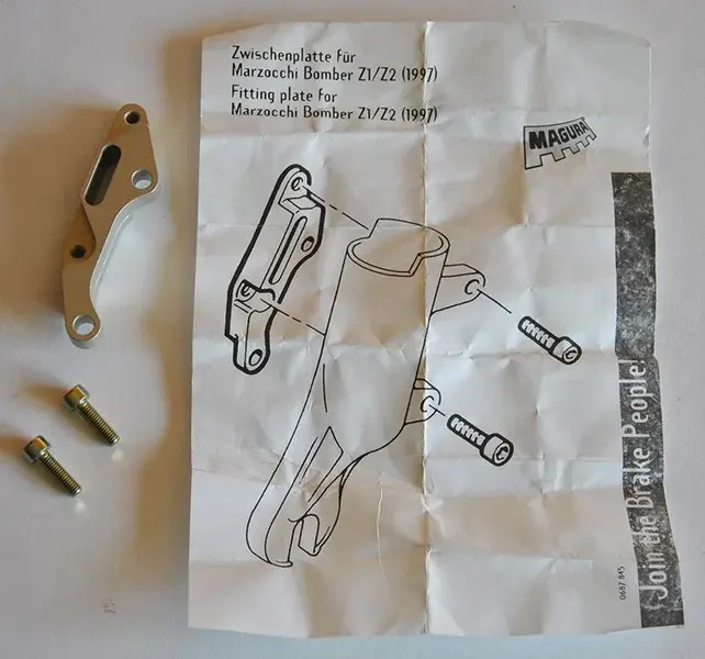

I've seen the thread on the custom FS to IS adapter group buy, but I was wondering if anyone does a straight FS to Post mount adapter which I reckon would be much stronger.
I've also just emailed this chap in Germany who supposedly makes adapters. They're a slightly different (better?) design - it bolts onto the inside of the tabs and is a Z profile to allow an IS adapter or caliper to be fitted without spacers.
http://waldmeissler.de/fahrradteile-bremsadapter.html
Not too dissimilar from the original Magura adapter

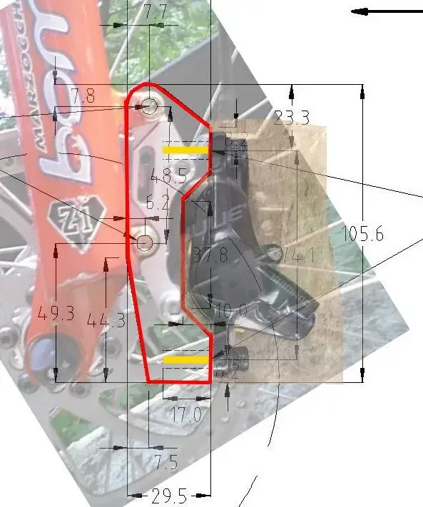

So i'm going to try and make (or rather get made by a friend) a straight FS to Post mount adapter rather than mess around with the hammerhead adapter and spacers. Hopefully it'll be quite simple as it should just be a rectangular plate with 4 holes drilled and some bits cut out.
I've worked out the dimensions starting from the FS -> IS .dxf file for the hammerhead adapter off the facebook post facebook post and superimposed/rotated IS and PM dimensions on it to fit
I'll report back if successful, but if anyone else wants to have at stab it, below is what I've worked out. I've sanity checked it with measurements from my fork and it looks in the right ball park. There isn't much clearance at the lower tab, so some filing may be required.
It's not the most elegant shape but it should allow everything to fit (fingers crossed)
Oh and it's based around a 160mm disc
The dxf is available on my Dropbox

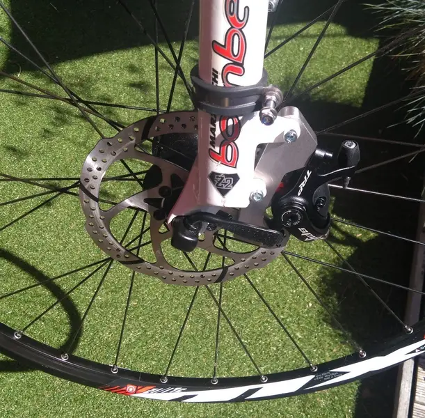

Funnily enough it just arrived in the post this morning from a friend who kindly made it for me.
The dimensions seem correct and the pad touches the 160mm disk properly so I'm happy to say it fits! It's a bit on the heavy side as it's quite chunky compared to the modern adapters, but as it does the job I'm happy.

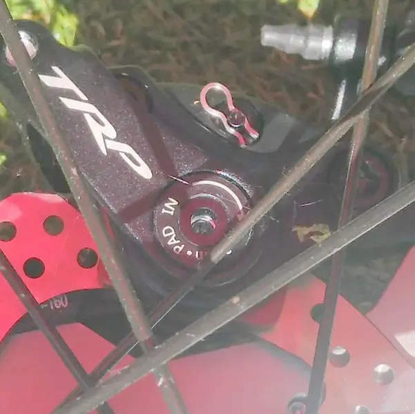

If you have some adjustment from elongated holes in the caliper, you could actually use 10mm thick plate and drill the holes centrally. This is what is mine is because I couldn't get 12mm S/S plate
For example, there's a good 4mm of lateral play in the TRP Spyke that can be used to line it up with the disc - https://cdn.bike24.net/i/mb/8a/dd/08/22 ... 431456.jpg
