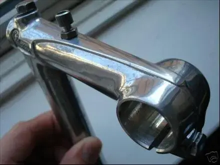

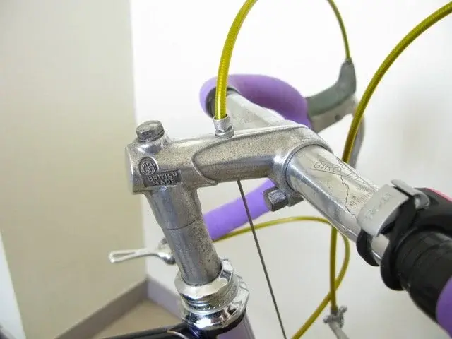

There used to be a lot of GB stems around that were drilled to take a centerpull brake cable stop/adjuster, I doubt they were factory done but it might be worth looking in to.
