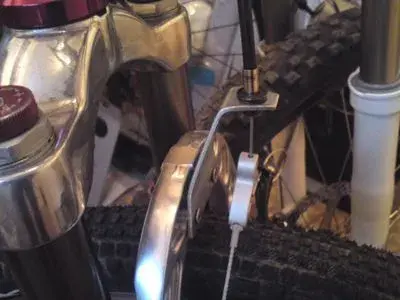

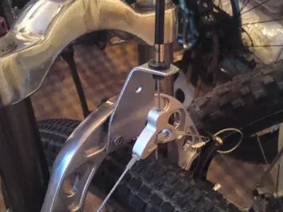

Yep had the same problem. Thought I would use a stem mounted hanger but forgot about the problem with the forks compressing.
Could not find a hanger anywhere for my z1's.
After a chat with Lee (Mrlee) on here I had came up with this for now. :wink:
