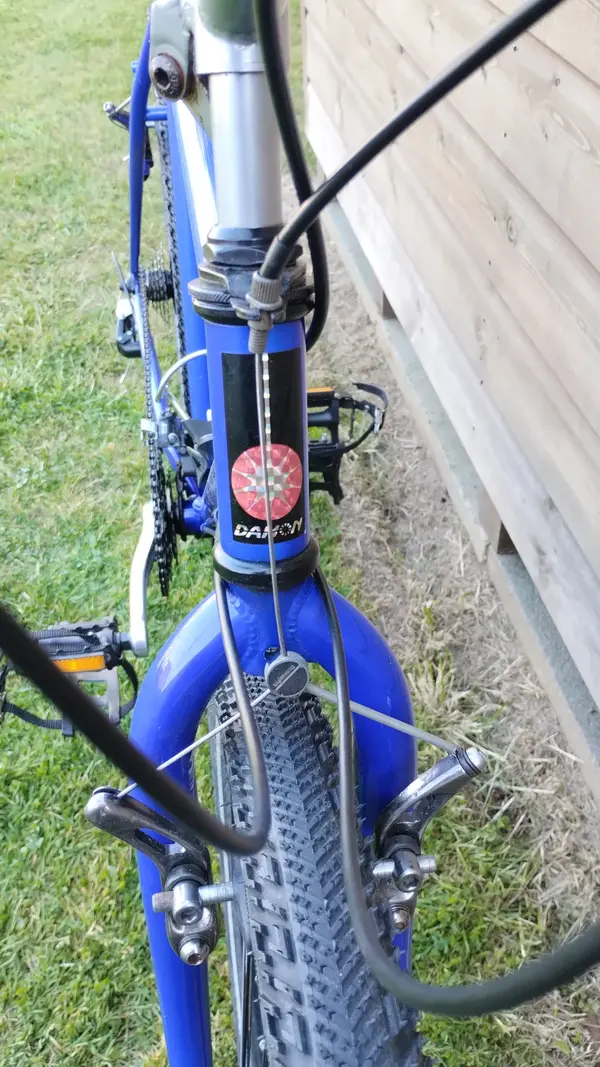

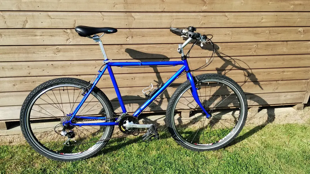

Mid 1990s Dahon folder. Bought from the original owner who got it free when he bought his Mazda. The wheels, cantilevers, seat post were changed because the originals were awful quality. Grip shit was changed because I hate it. The bars had no pull back, lay them on the bench they were flat. I changed to my standard straight bar. Turns out it's quite a nice bike to ride. I need to fit bar plugs and change the headset and horrible steel cable stop to finish it off.

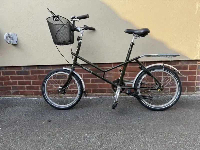

on the twenty theres a 76mm shell width, it looks original, they are normally refaced to 73mm, you cant get them down to 68mm unless you use a 130mm crank after or longer, if you want to fit, twin rings.
I cut the shell on my Twenty to 68mm and used both road hollowtech and Sugino 75 cranks on it. I’d have had the Suginos on a 107mm bb to get the chain line right.
