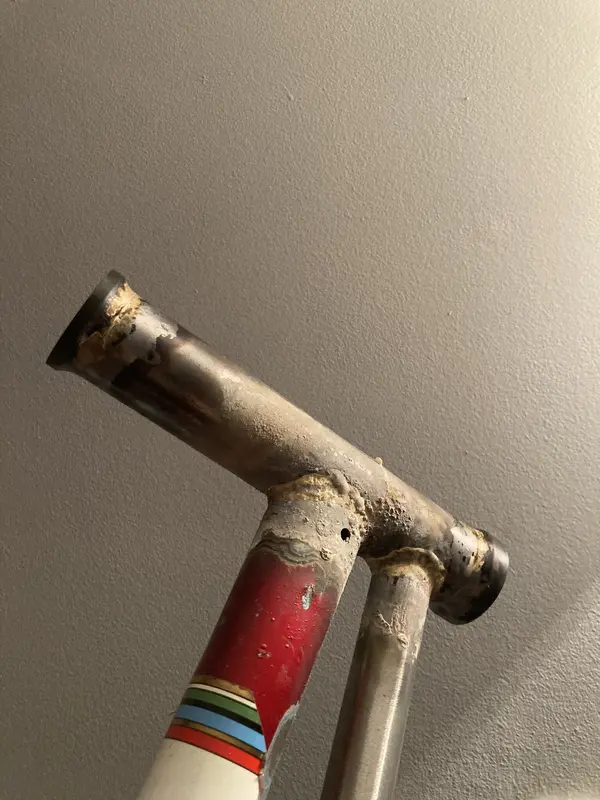

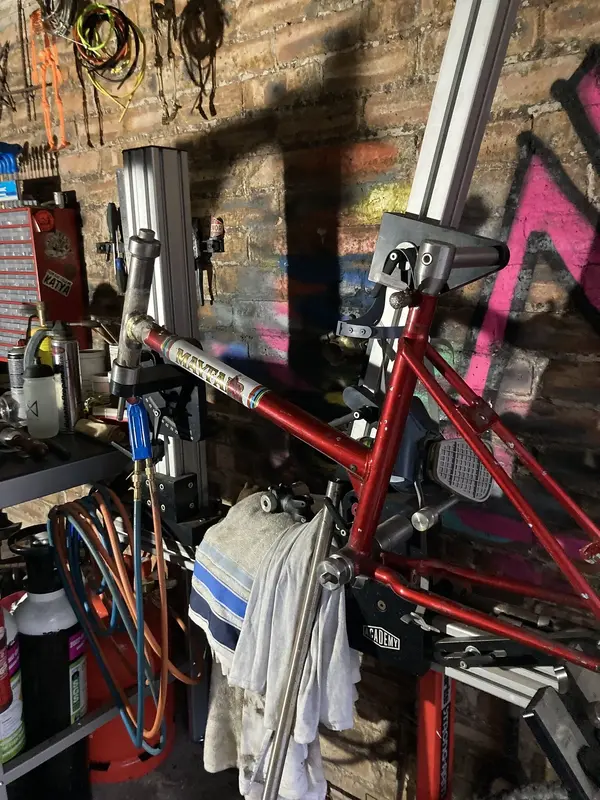

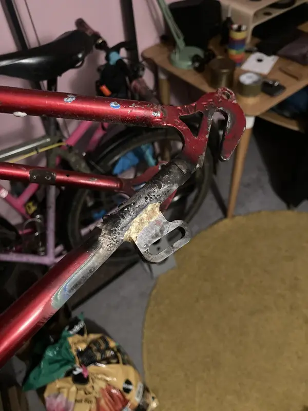

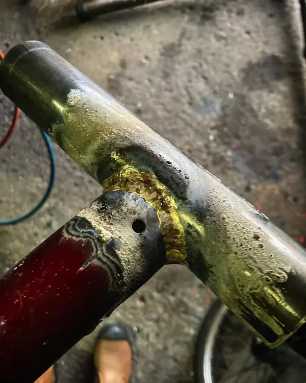

Here it is with the cups soldered in place.

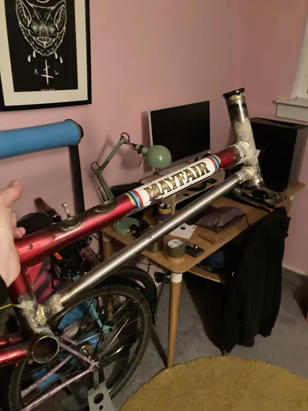

My actual Raleigh Twenty doesn’t seem to require an additional ‘top tube’ as some people do but being an unknown quantity and probably not as well made as a Raleigh I’ve decided to as a second bracing tube to this frame. I’ve done it under the main tube instead of higher up though to retain the step through nature of the frame.

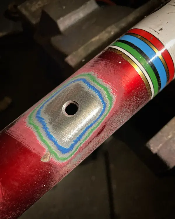

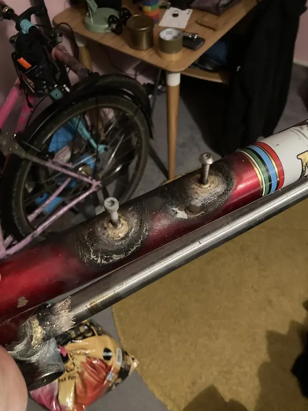

I’ve also added water bottle bosses to the main tube and a coaster brake tab to the chainstay.
Not sure why they painted it blue then green then red but it matches the decal at least!
