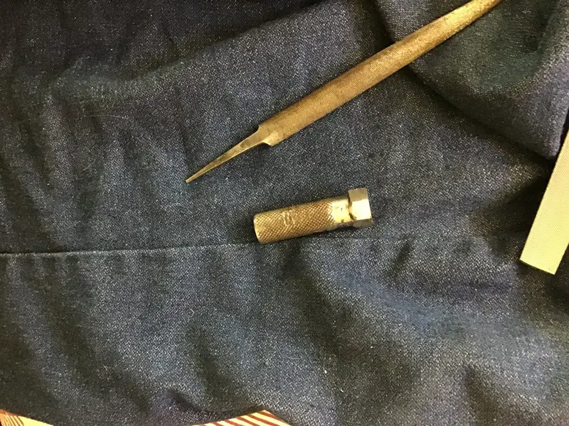

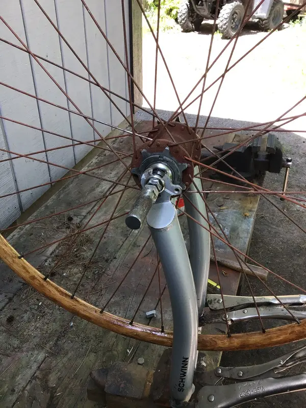

This bike is designed so that the seat is almost on the top tube, its a tall bike compared to what we ride today. They were hard to mount so sometimes they had a mounting peg on the left rear axle as you mount a horse from the left. You could also get foot rest pegs for the front fork if you didn’t want to spin downhill. I made a mounting peg out of a $2.00 thrift store wrench. Tool steel is hard so it went into my fire pit over night. It’s now easy to file and drill. Will I need it? It’s hard to tell but I’m 5’8” and 76 years old so there is a good chance I’ll need the assistance. You can always lean on a street sign and push off but a peg might be more elligant. Two dollars for a homemade one beats $100 for the real old crusty deal that might not fit your threads. FB322CC2-A265-4243-B3BD-D96D699B3D77.webp D52EAEBF-10B3-49FE-B3F8-944632099BF1.webp image.webp
Approved. As long as you don't enter the local track sprint. ;)
Very ingenious.
I don’t think it sticks out as far as a pedal, so it should be OK cornering. On a track it would be dangerous to others. Here is a real one, but they costa lotta. I may shorten mine up a bit, not sure if I’ll even use it so good enough for now. 82694FFE-1C23-4FC1-A4DB-6D6F99BD200B.jpeg

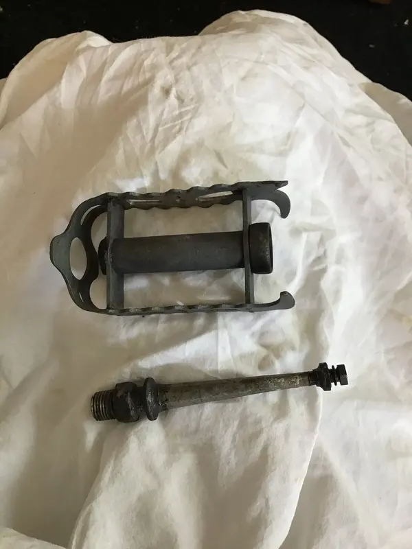

Following on, are they Pista (track) pedals without a quill?
Not track pedals on the Vicky, at least as we think of them now. My 1930s Claud Butler DSH track bicycle has quill pedals but the left has a shorter spindle. The Vicky also has mismatched quill pedals with a shorter left pedal. This bike was heavily used, worn and crashed so it’s possible it’s a coincidence that the left pedal is shorter. Some old American track bikes had quill pedals, others no quill. 0D6B651F-CB01-47A2-99B2-BAB080DB1B2B.webp
