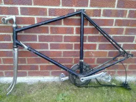

Well here it is so far. I have (not very scientifically) weighed it and with the bits still left on it weighs 6.3KG - lighter than I expected!

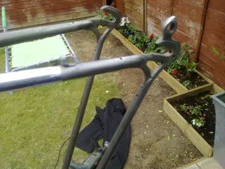

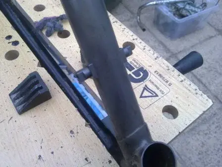

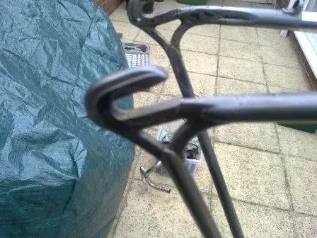

Got the forks off now, the bolt section of the quil stem had a bit broken off so gonna need to get hold of a new one from somewhere. Gonna strip the paint off and see what is what.
Still got to remove the cranks but havn't got a tool yet. Started to remove the paint, is anyone able to tell what type of tubing it might be? It is very grey coloured!
