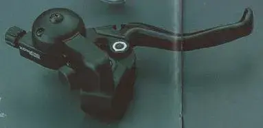

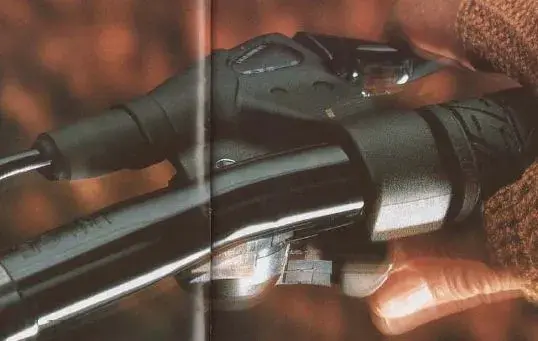

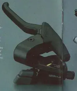

XT one is not the 1990 versions, but the revised versions of 1991 with SLR+ (I still love the look of the window in the XT unit here)
Got DX on my Fisher Montare in 91.The first push/push shifters were rubbish,mine lasted 5 months and were then replaced for thumbies which also meant new brake levers,got it all under warrenty though 8)
