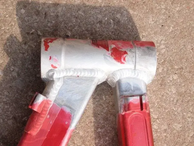

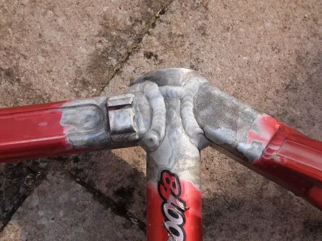

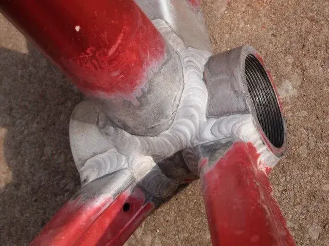

Update from Dan:
I finally managed to get a caustic mix right which would strip the red anodising.
It was pretty strong, so I didn't want to do the whole frame, just the relevant areas
The Anvil frame jig arrived last week, (only 5 months late...), so after a quick bit of familiarisation, I hope to get your frame done this week or next.
Yay! looks like we might get this one rolling soon :D
Some snaps from Dan. Poor frame looks like its suffering

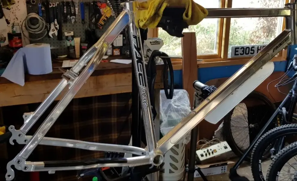

and Jez, I'm definitely leaning towards an original looking finish over something too crazy, its getting the right look that's taking the time. Not sure I want to go matt black, rather a shiny ano-looking finish.

RickTheUncivil":3dvob6uj said:
my logic is similar Spud - if i buy a non-broken frame, it will break. It appears that they all crack in the same places. By taking this route, Dan is putting good tubes in where a minter would have cack tubes, meaning it *won't* break. :D
Its a bit like it being the F9, a development of the F8 to fix the weaknesses.
Maybe I'll get some custom F9 decals made up and confuse people....
Re: Another Pace RC200 Rescue Thread
TheBear1978":ouuv99ct said:
Now that would require a MoFo amount of elbow grease and an industrial polishing wheel to get it like that
And even then your not finished as it would need either a clear coat (not that durable on a polished surface) or a clear powder coat applying
To be honest unless it was a frame with special significance or a bonifide unicorn then it’s not worth it. Besides by the time it was finished to a factory standard I’d wouldn’t be able to ride the darn thing knowing how much time and effort was invested.
That’s two posts now in the post 97 section for me :shock:
Off to thrash myself now with birch twigs and freshly dug stinging nettles for this out of character transgression and moment of weakness
