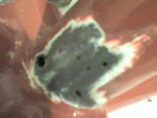

OH YES THEY DO :evil:
I know of no other make of frame that rusts inside to out,so they DO have a rust problem.I worked with bikes from the fifties in the shop which have never had the post removed or any type of antirustgoostickystuff put in and no rust
How many people think it`s correct that you HAVE to put frame saver in a steel frame so it lives longer,mine now has what it should of had from the start and thats a hole connecting the bb to the seat tube

i've seen yetis have the exact same problem. the nickel plated rusted marins rusted inside to out (the steel sweats & rusts.
you were unlucky dude. FATs have got a bad, in my mind ill deserved rep thru rust, yeh they shouldnt have sealed the breather holes, woulda helped a lot. but they're not the only people who did this!
My Serotta made Yo has a hole from seat tube to BB from the start.

To me it sounds logical that blank steel, less than 1mm thick in a non ventilated area will rust through eventually. Drilling vent holes will help, but would not do that solely. I have more faith in that proper surface threatment, preferably with quality rust prevention greases and oils is more effective.

so answer to your question matey is that yes afew fat chances have been know to rust at the base of the seat tube,and even crack,but this can be repaired and prevented if noticed in time.
